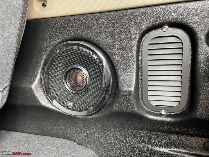

Rear Speaker is walk in the park, STADIUMGTO620 is press fit (rarely I get this lucky), but stock screws can't be used. Also made improved fitting for forced ventilation vent, still using double sided tape since tabs are broken from factory.
