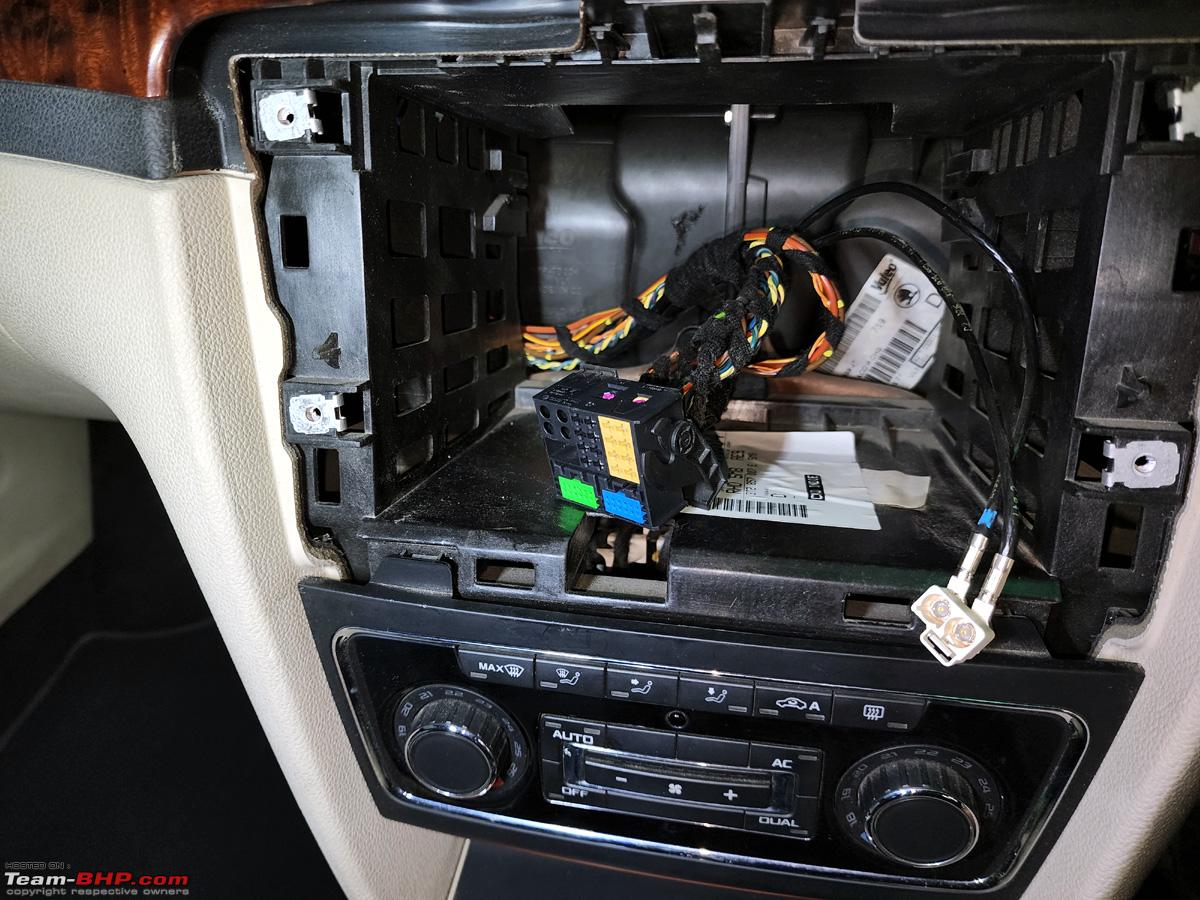

A look at the empty stereo cavity in the car with the connectors freed from the stereo -
Skoda Superb - A tryst with destiny-skoda-superb-stereo-removal-19042024_13.jpg
A closer look at the Quadlock connector and the plastic lock clamp which needs to be moved in the direction of the arrow and vice versa to unlock/lock it to the stereo -
