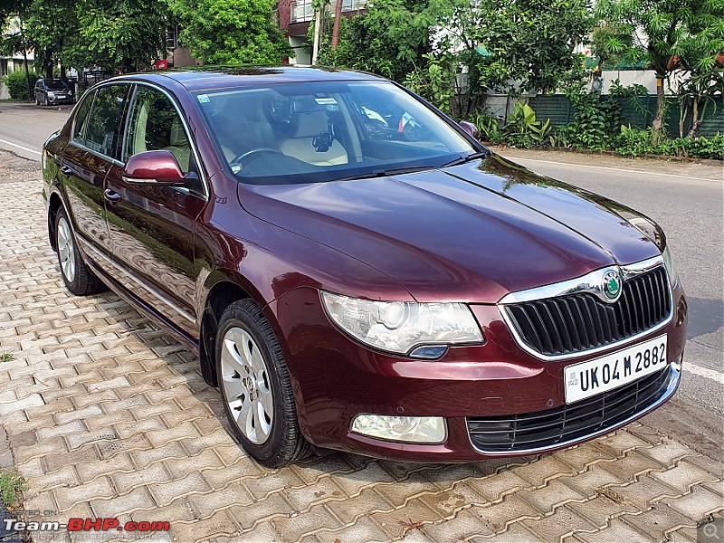

Front view -

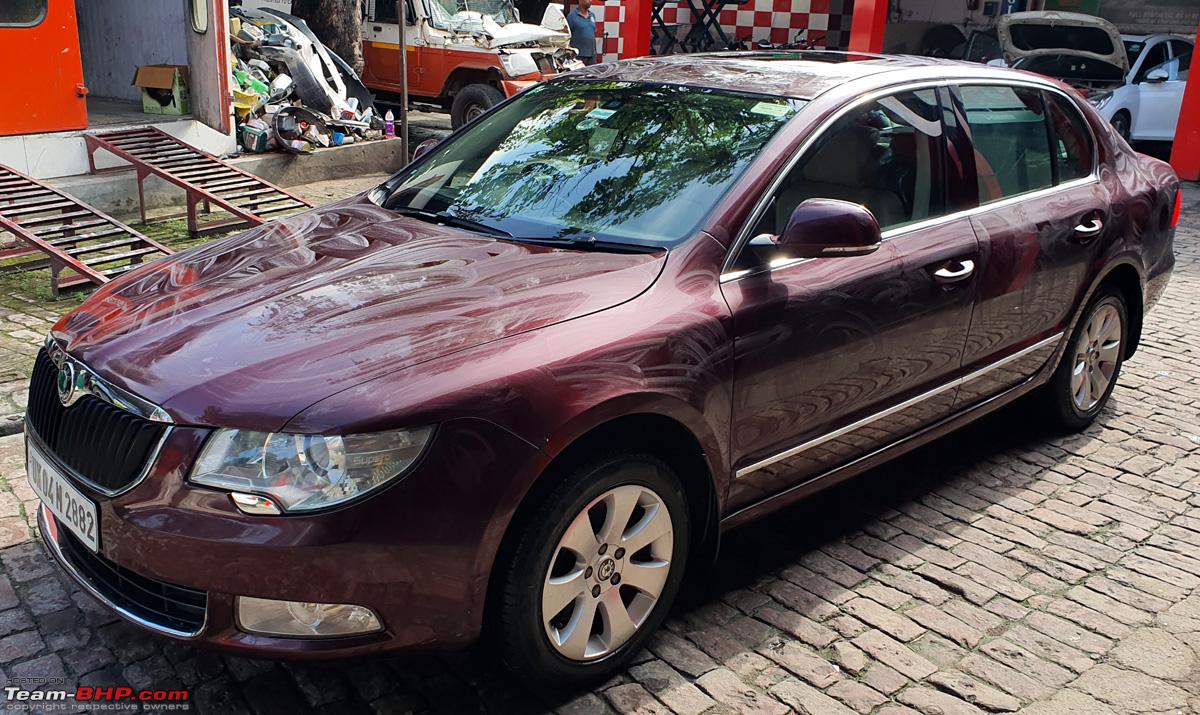

Simply Clever?

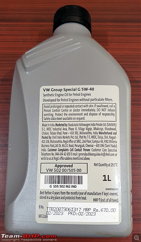

The highlight of the package was this new VW Special G - Fully Synthetic Engine Oil - SAE 5W40 - VW Grade 502/505, which was now available at the dealership -
Skoda Superb - A tryst with destiny-skoda-superb-service-parts-new-03082023_3.jpg
The MRP was Rs. 670/- per litre i.e. Rs. 3350/- for the 5L and it was confirmed by the dealership to be good for the 15000kms oil change interval. However I got this at a discounted price of just Rs. 2500/- from the dealership. Good deal!! In comparison, Castrol Edge Magnatec was for Rs. 4300/- for 5L. And this VW oil is specially formulated for my model of cars i.e. one's without particulate filters -
Skoda Superb - A tryst with destiny-skoda-superb-service-parts-new-03082023_4.jpg

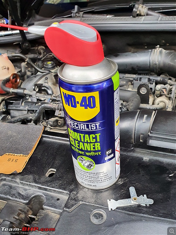

WD40 Specialist Contact Cleaner was used to clean them, and did a commendable job -

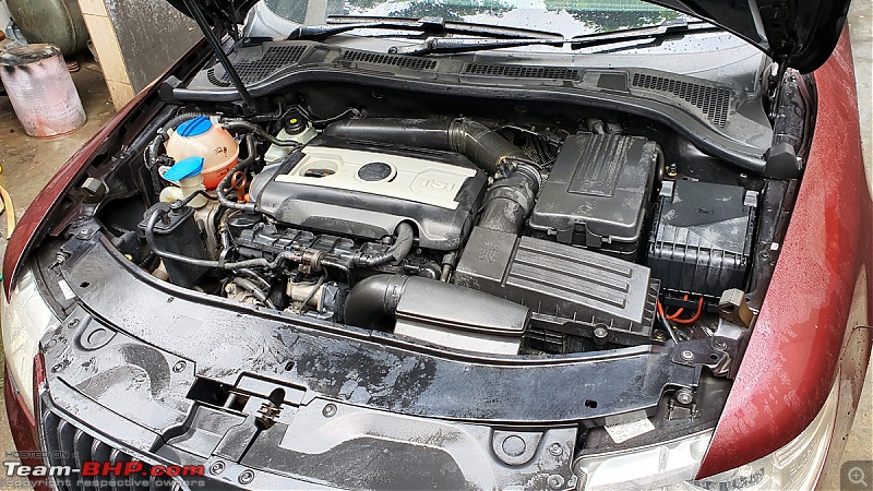

The engine bay was carefully and meticulously cleaned by me personally, especially the top TSI plastic cover over the spark plugs -
Skoda Superb - A tryst with destiny-skoda-superb-11th-year-service-37161kms-04082023_13.jpg
