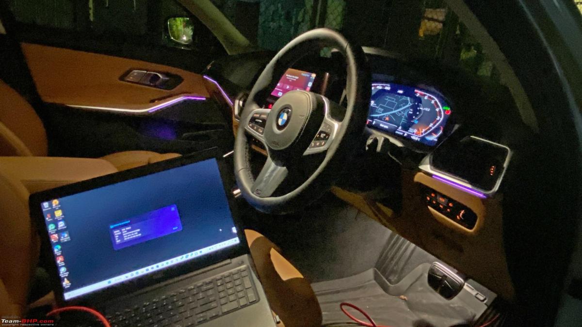

Here's a photo of my car during the process:
