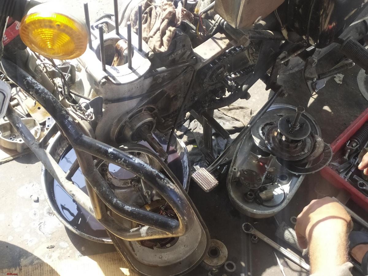

After the block had been removed
The right side was also completely opened up as I decided to have the chain sprocket changed after a close look at the rear sprocket which was looking a bit saw-toothed. The clutch plates were also changed.
