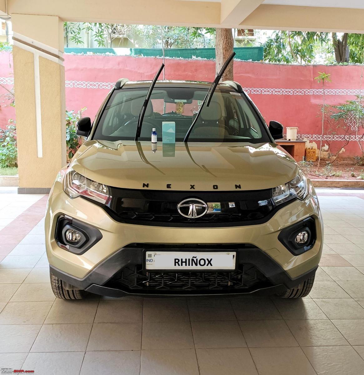

Weiruixin 10H Ceramic Coat – Inside box: ceramic coating 50ml, applicator sponge, application clothes 5pcs, wiping towel, protective gloves, and user manual.

Next day, cleaned the scattered dust particles with a dry cloth and once again buffed the surface before applying the ceramic coat. First coated on the main paint elements - hood, fenders, doors, boot lid, and bumpers.
How to apply - Wrap the cloth over coating sponge and put 3-4 drops of coat liquid on the cloth. Starting with hood, spread the liquid on half portion of hood first by applying in straight lines horizontally and then vertically to cover the gaps. Then coat the second half of hood in similar style, meanwhile the first half will get dry (it takes 5min to dry) and buff the coated surface in circular motion using the wiping towel.
Always clean the surface with a dry cloth before applying the coat and change the applicator cloth when it becomes hard.
By repeating the above procedure, I completed coating the whole car including alloy wheels except the roof.
Planned after three months of first coat and was able to finish it in one day. This time I restricted the cleaning process, washed the car with shampoo and later cleaned the surface with isopropyl alcohol (mix isopropyl alcohol and water at 1:3 ratio in a spray bottle). Cleansed with water again and wiped with a dry microfiber cloth to remove water droplets on paint. Then polished the car with ceramic infused paste wax, pre-ordered from Auto Bros for long-term use. On confirming the wax is fully absorbed and the surface is totally dry, I started second layer of graphene coating. The application process is identical but, use a new microfiber towel for wiping the coat. This time I ended with coating the shiny interior parts.
