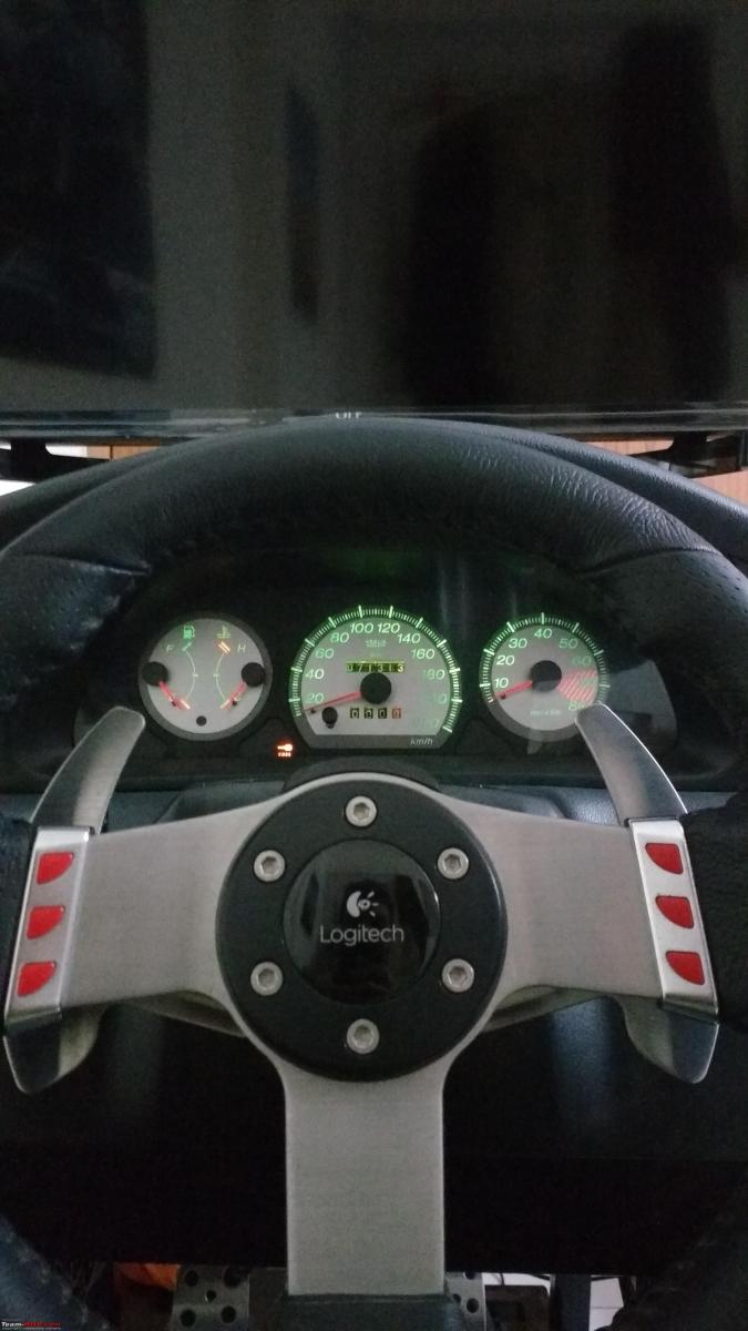

Post this procurement, the designing & fabrication of the body for the simulator started.
  • Firstly, I cut the dashboard in half in order to save space & make the setup compact.
  • Secondly, used a mild steel setup for the fabrication part & a checkered plate in the base (Pedal location).
  • Thirdly, designed it in such a way that the screen can be swivelled 90 degrees so that it can be used otherwise for playing other games as well when not on the seat.
Post all the fabrication process, I gave it a good sanding & a spray of red oxide primer followed by black paint & clear coat.
Installed a VU 32-inch screen & connected the setup to my PS3 & Alienware.
Also, with help of a friend, connected the lights of the IC, Dashboard & digital clock to a 12V adapter for better aesthetics.
Below are the pics of the completed project after installation in my room.
The ergonomics of the whole setup are definitely not the best (vs professional setups), but since it has been built as per my dimensions so I and even other friends of similar build are able to fit in easily & have a good experience overall & the best part is that I get to relive at least some part of the old days of my Fiat Petra.
