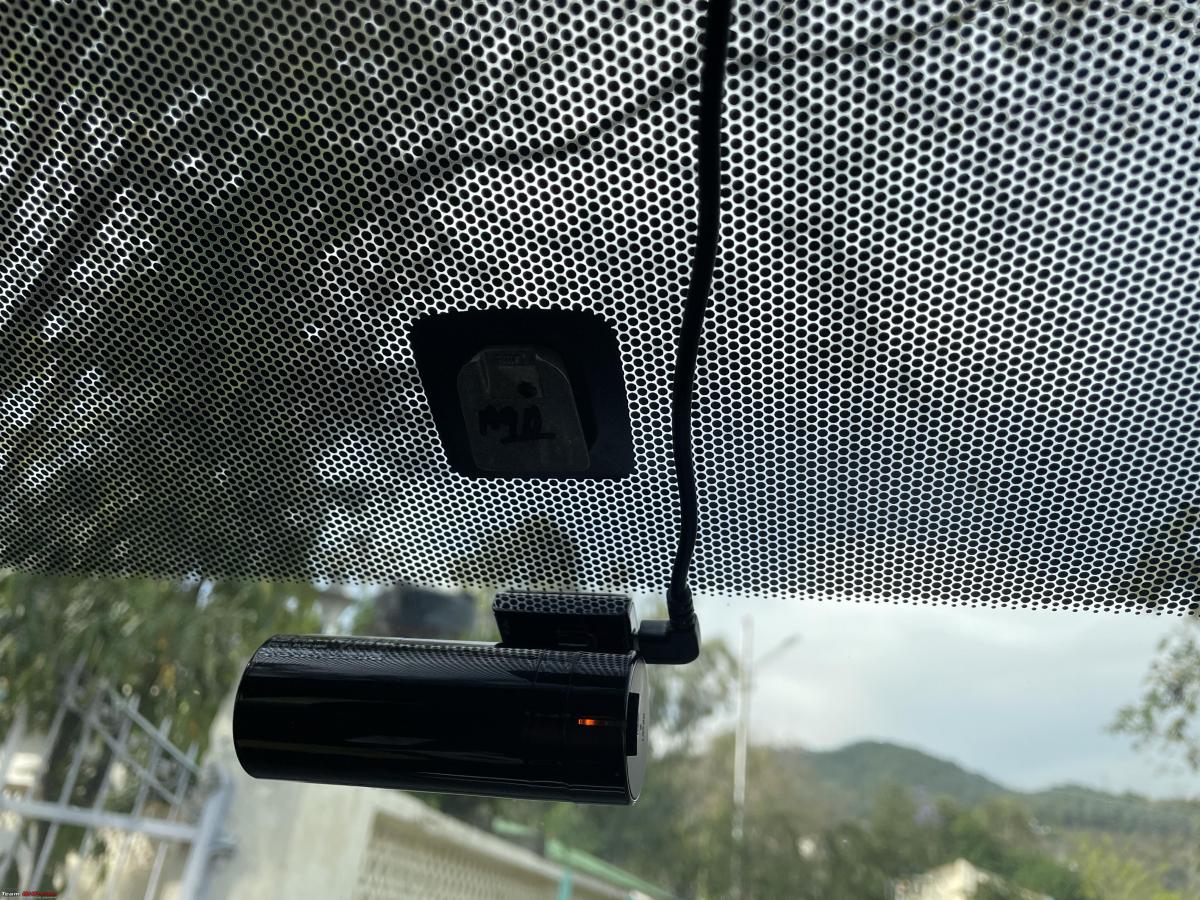

Attach the camera to the windshield. Keep the camera powered on and connected to the app for correct alignment.

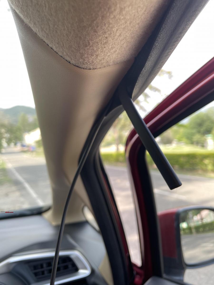

Pushing it under the A pillar is a bit of task

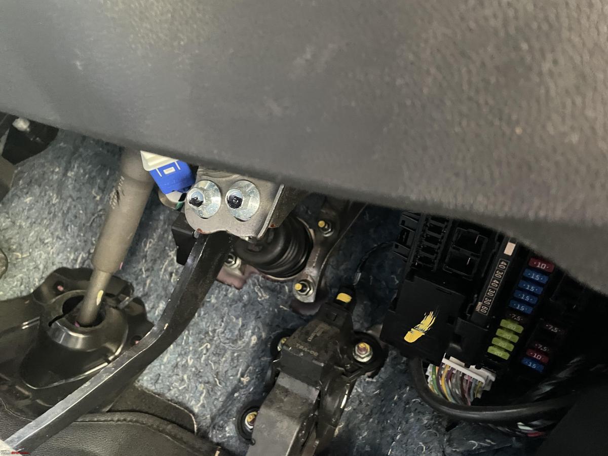

Cross over the footwell. This step is blind and one has to depend on his tactile receptors. Use zip ties to hold. I used two zip ties. Could not take pictures to do justice to the cable placement, as the area is inaccessible.
