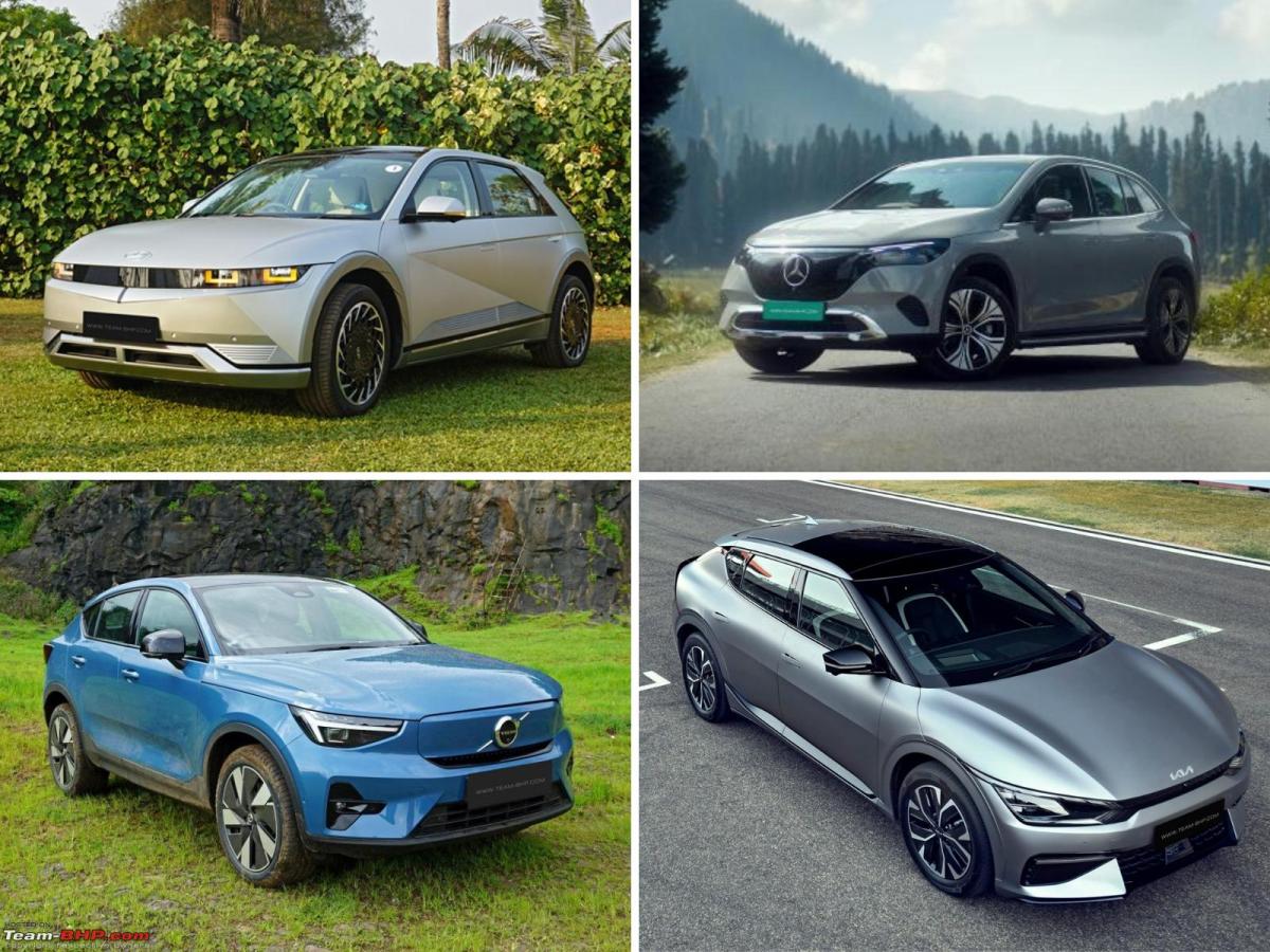

It was Porsche who first brought the 800V architecture to its road cars with the Taycan. They had used the tech earlier in their Le Mans-winning 919 Hybrid race car. Some of the cars that use the 800V system are the Audi E-Tron GT, Kia EV6, and Hyundai Ioniq 5. The Mercedes EVs like the EQS sedan and the EQE SUV are currently using the 400V system but are rumoured to be receiving the 800V system soon. Most of the other EVs are still using the 400V system, but as time goes by, they might also consider shifting to the 800V system.
