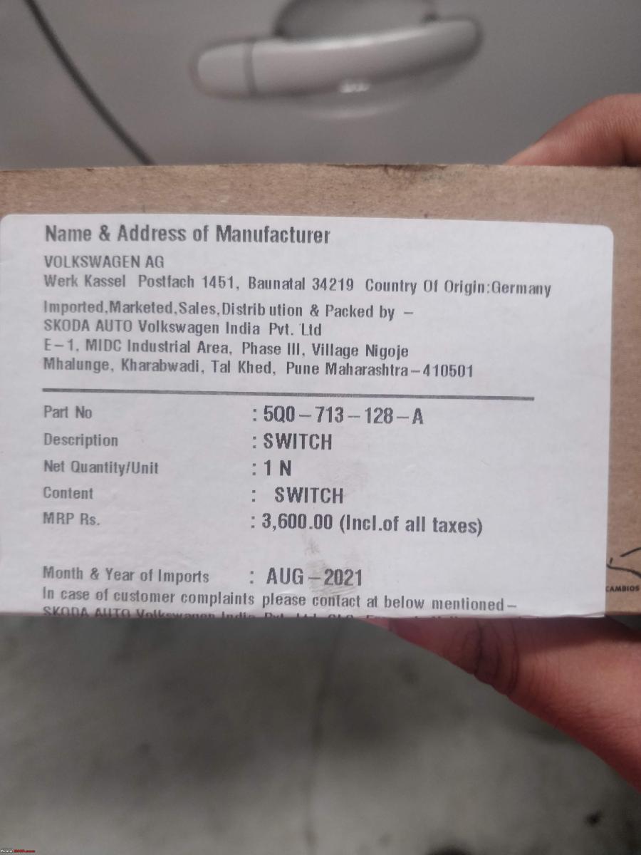

So after a few weeks of waiting (part availability), the ASC has finally fixed the problem  Turns out the issue that was causing the problem was not the ignition cylinder, but a shifter micro-switch that gets installed in / under the DSG gear lever. This is responsible for communicating and letting the ignition lock know that the car is in which gear and whether or not to release its lock so that the key can be removed. Once the part was changed, there were a few adjustments to the DSG lever that was required since there were "metal-grinding" sounds when we changed the gear from "P" to "R" and "N". Given that the parking PIN within with the DSG is just a small piece of metal, on highlighting the sound during the collection of the vehicle, the ASC technicians acknowledged the issue and the required alignment / adjustments were done on the DSG lever, making it "stock-like".
Part #: 5Q0-713-128-A
Link - Since I do not have a picture taken of the actual switch (Was replaced just before I reached the ASC)

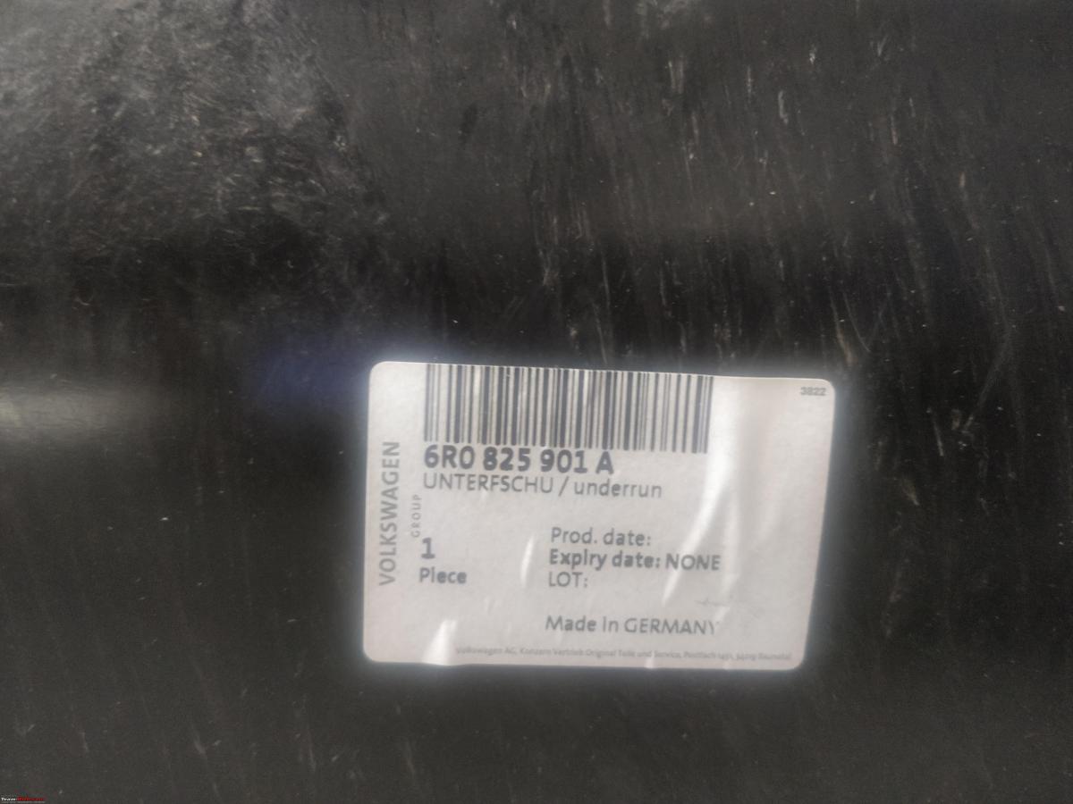

Another upgrade that I found useful was the installation of the Under-body guard right below the engine. Got it installed from the ASC.
Part #: 6RO-825-901 / 902 - A - Apologies for the bad image quality.
Before Installation:
Post installation:
Note: In-case your area / parking space has rats, I'd avoid installing this as it will give them a nice small space to climb and cozy up.
