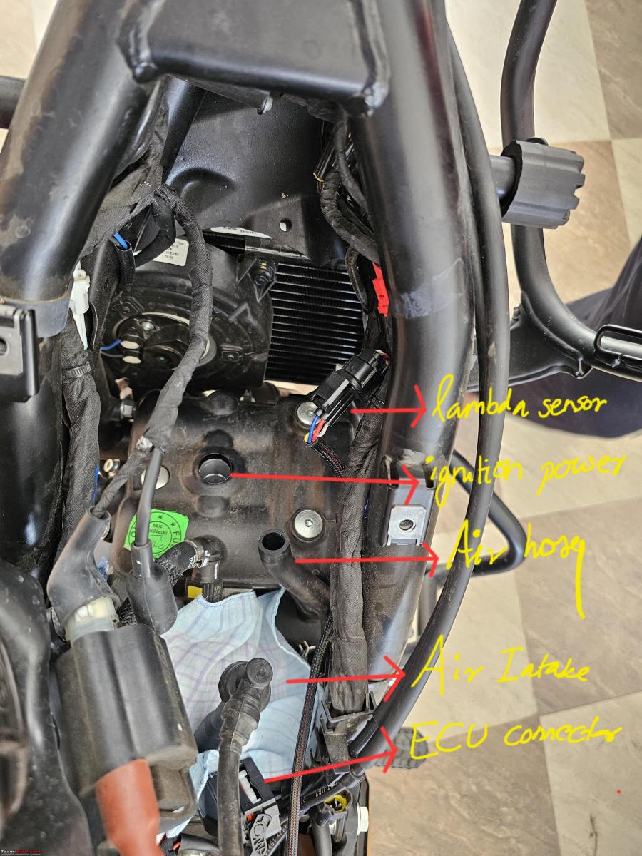

Successfully installed Fuel X Pro+ in my 452. Removed the airbox to reach the lambda sensor. RE has really made it hard to reach it. Was able to locate the sensor without having to remove the airbox. But was unable to find a proper way to disconnect the connector and route the fuelX harness. So, took the tough way by removing the airbox to one side as per the instructions given on the fuelX website. I would strongly urge those interested in installing fuelX to seek professional help if they don't have any DIY experience. Because removing the air hose and putting it back was really a pain in the behind.
Lambda sensor in full view with the airbox moved to one side:
The length of the airhose is short and was difficult to get off and put it back.
