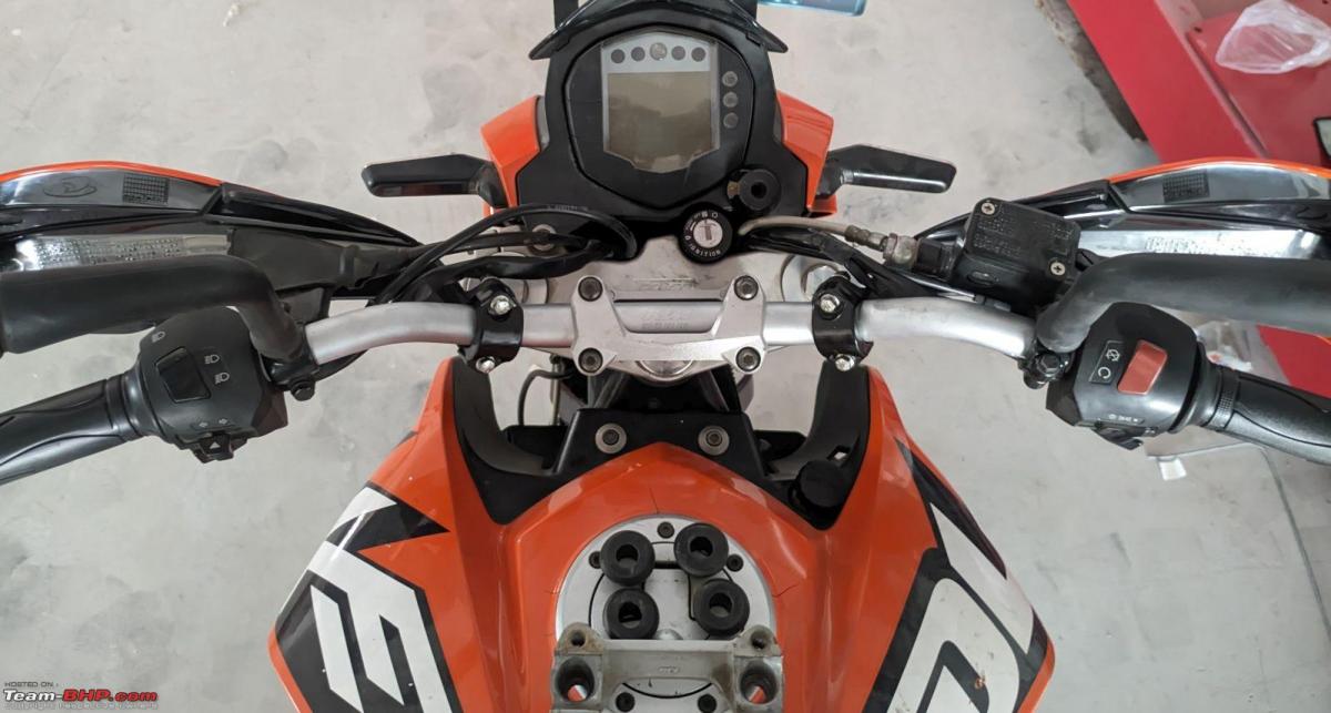

The handlebar bend was a simple fix, take it off, get it straightened. I didn't have the time so ended up swapping it to a new handle. Even with the new handle, it was bent towards the right. I then noticed the base was twisted to the right. Ended up buying a new handle base along with new rubbers for it. Even swapped out the scratched bar end weight with a new unit. Handle Grips swapped to new Apache RTR units.
