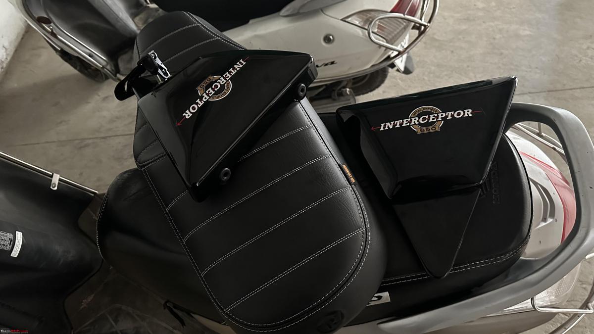

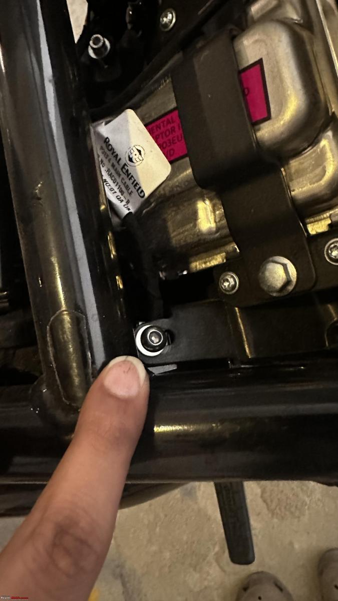

First step is to get the side panels and seat off the bike as the relays are accessible under the left-hand side panel. Be careful while pulling the left side panel as it involves getting the Allen bolt off on the frame under the seat and then by holding the left top corner, pull the panel towards yourself and it pops, then pull the panel upwards to get it off.

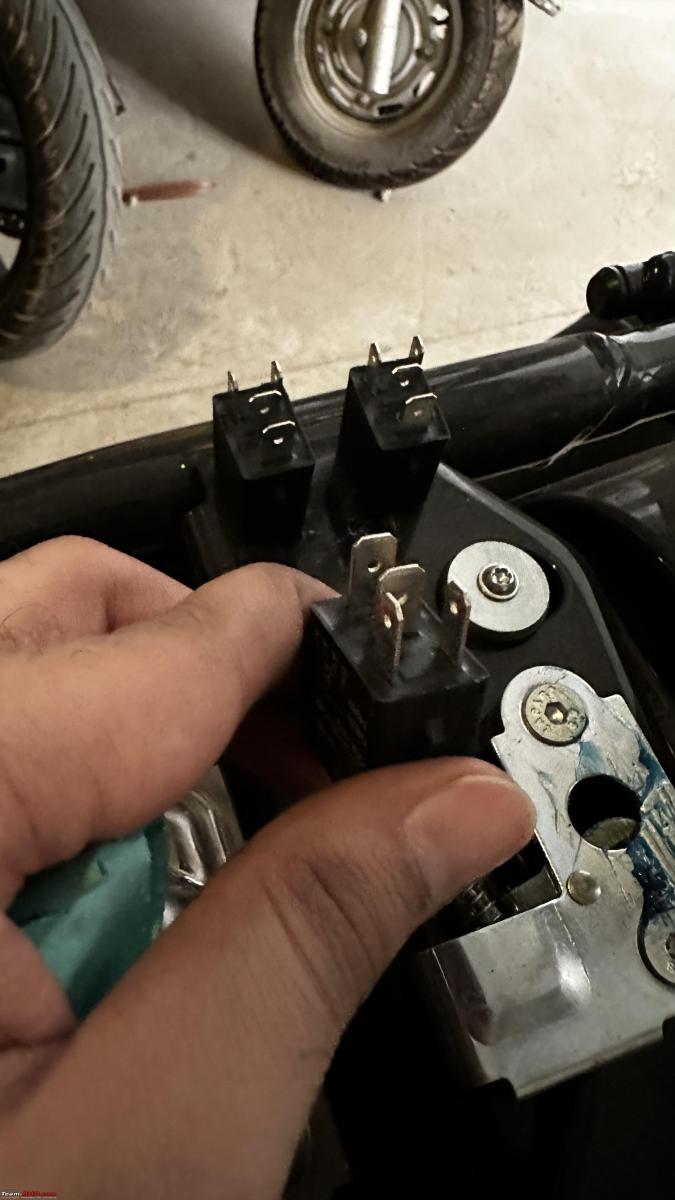

Once the left side panel is off, you’ll have access to the relays which are held in position by clips behind the sockets.
Pull the relay sockets upwards off the clip and then the relays out. You can see the relays fully covered by grease. If you’ve OCD, go ahead and mark the relays to get them in exact same positions.
The connectors and relays are goofed up with too much lithium grease which hampers the conduction of electricity, heating up the relays and ending up stalling due to the fuel pump not receiving the required wattage.
Now shake the contact cleaner, point the nozzle at the relay connectors and give a thorough spray to get the gunk off. I’ve used a lens cleaning cloth around the smallest Allen key (toothpick does the job too) to wipe any remaining grease and moisture off the connectors.

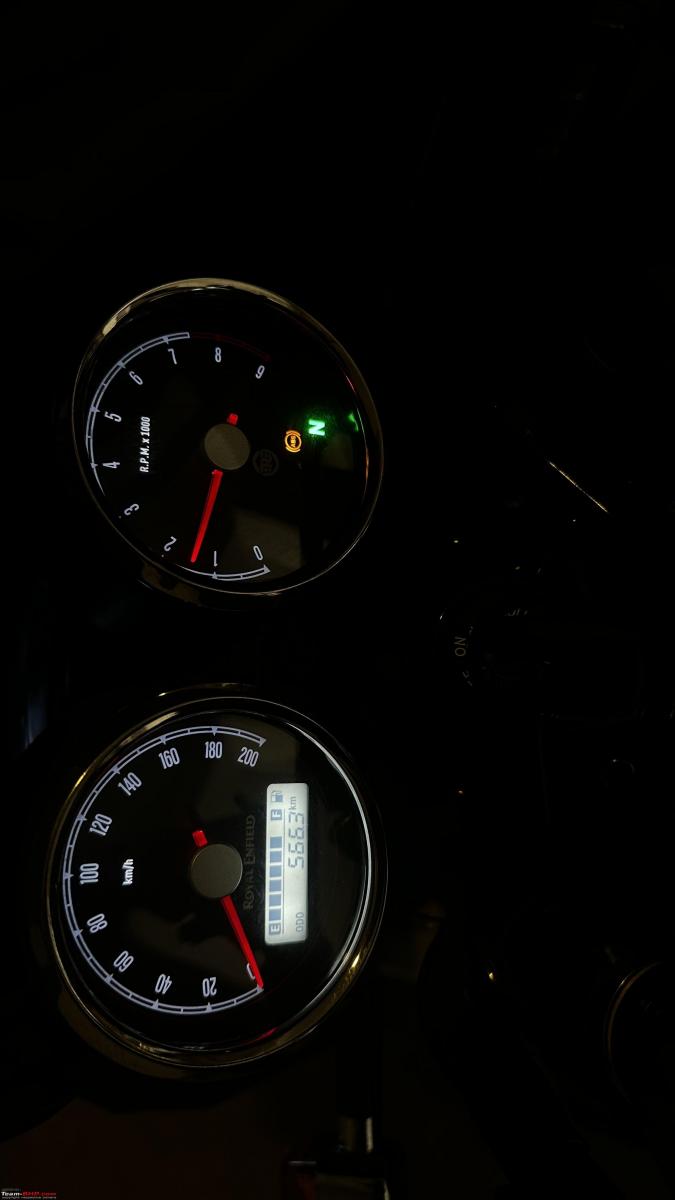

Once done, make sure to turn the bike on and check fuel pump priming up, horns, indicators, and lights working, and that no CEL is thrown when started. Run it for a couple of mins to see if the bike idles fine.
