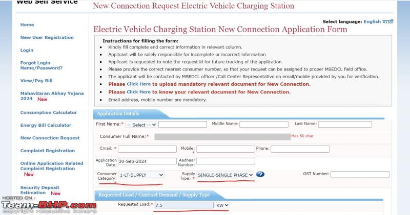

A. Online application process
  1. Visit MSEDCL portal. Link here
  2. Select the "New Connection Request" option
  • In the new page, select Electric "Vehicle Charging Station(EVCS)"
  • Select the below options carefully.
I am mentioning essential options here. The rest of the options are self-explanatory.
Consumer Category - 1-LT-SUPPLY
Supply Type - SINGLE-SINGLE PHASE
Requested Load -7.5 KW
Nearest Consumer No - It should be your existing residential MSEB connection number.
Name of Highway and milestone (if any) - NA
Ownership Details - Private Charging Station
Operation Timings(in hours/Day, except Holidays) - 1 (Mins) 23 (hours)
Mode of payment for charging - Debit / Credit Card
Whether facility of advance booking available - No
Manned/ unmanned - Manual + Automatic
Charger Type - Type-2 AC
No. of Chargers - 1
Charging vehicle type (Wheeler) - 2-Wheeler 4-Wheeler
Is Multiparty/Triparty Secondary Consumers - No
Please select option for payment - Provisional Estimate alongwith Processing Fees
