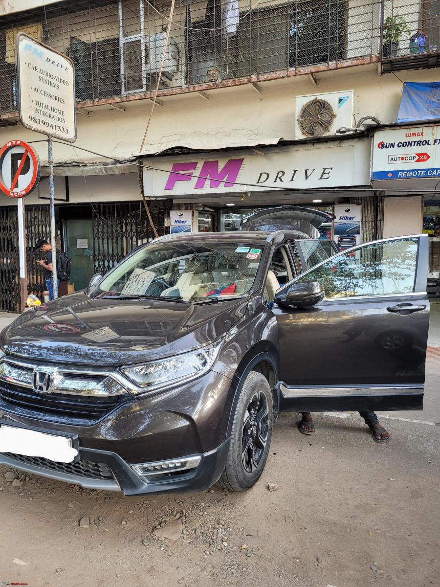

Finally decided to do something about it and began researching underseat subs, powered vs active setups as well as boom boxes in the boot. A quick search on team-bhp pointed me to FM Drive in SantaCruz Mumbai (it is located near the Straight line shop which I use for my wheel balancing needs) which had good reviews. The shop has moved to a new location nearby in the last few years.
After a lenghty discussion with Pankajbhai from FM Drive, a suggestion which stuck was the spare tyre subwooofer. This had an added bonus of saving boot space, which as a family man was a valuable asset to hold.

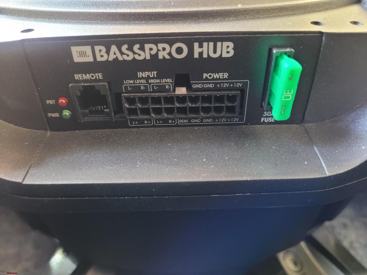

Speaker specs for JBL BassPro Hub -
  • Amplifier Power 200W RMS (2 ohms)
  • Frequency Response 30Hz – 150Hz
  • Fuse 30A
  • Maximum Current Draw 30A
  • Quiescent Current Draw <1.2A
  • Crossover Frequency 50Hz – 150Hz
  • Crossover Slope 24dB/Octave
  • Bass Boost 0 - 12dB Variable @ Fix 50 Hz
  • Line level input sensitivity 0.2 V - 4V
  • Speaker level input sensitivity 0.5V - 10V
  • Dimensions (D x H) 14-3/16” x 6-1/2”

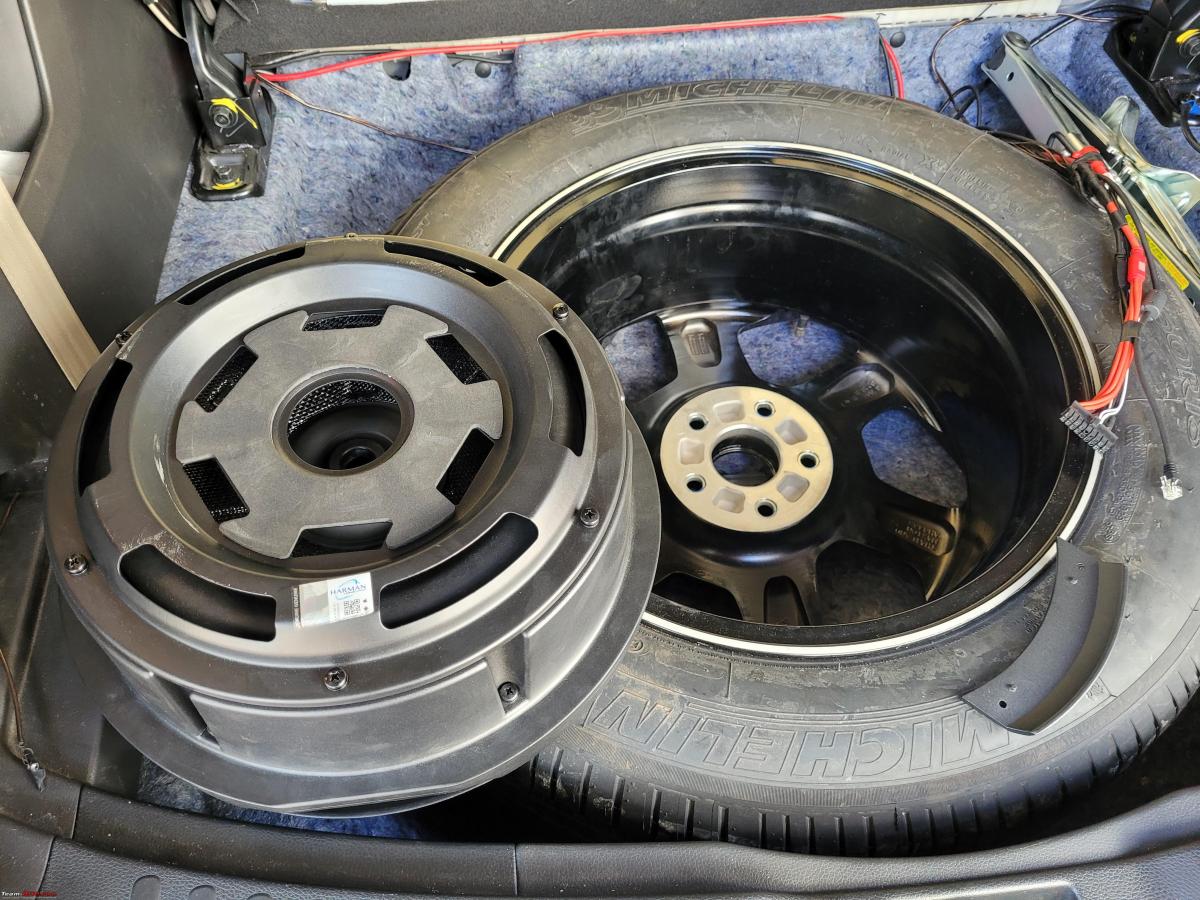

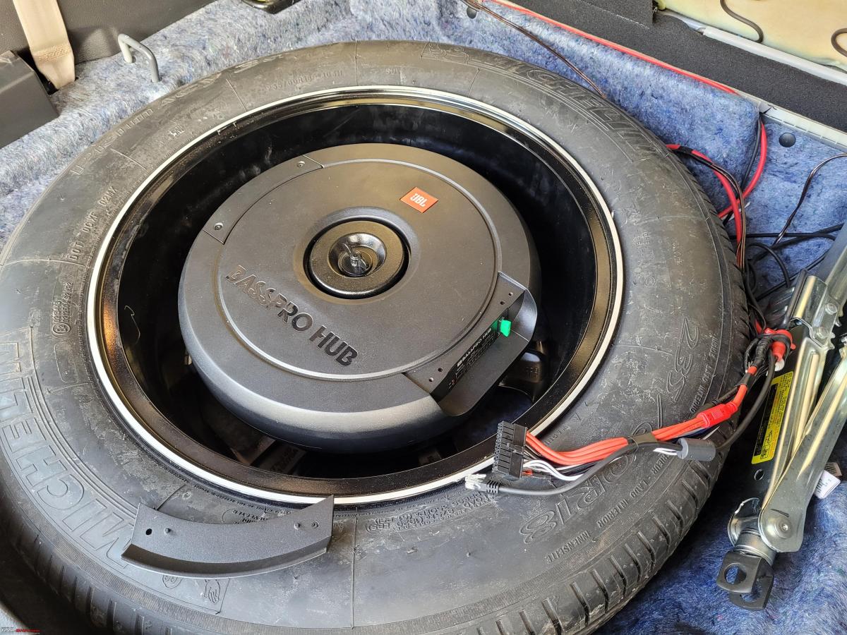

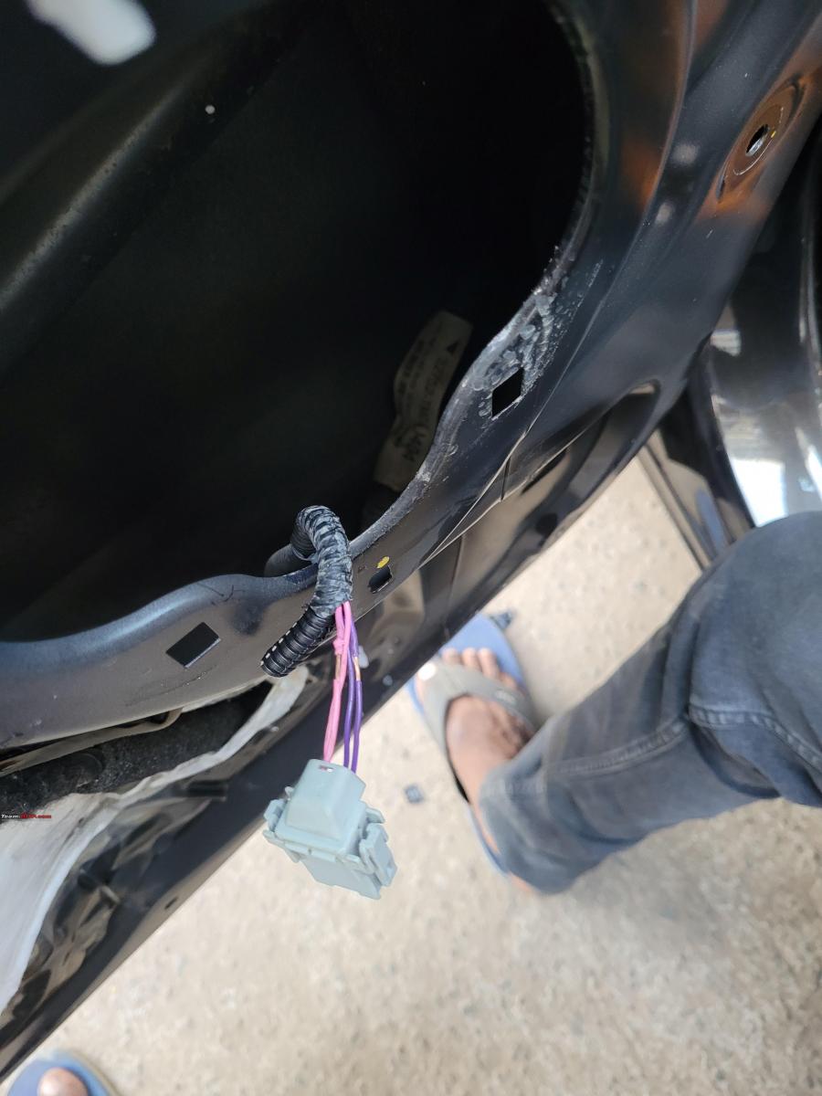

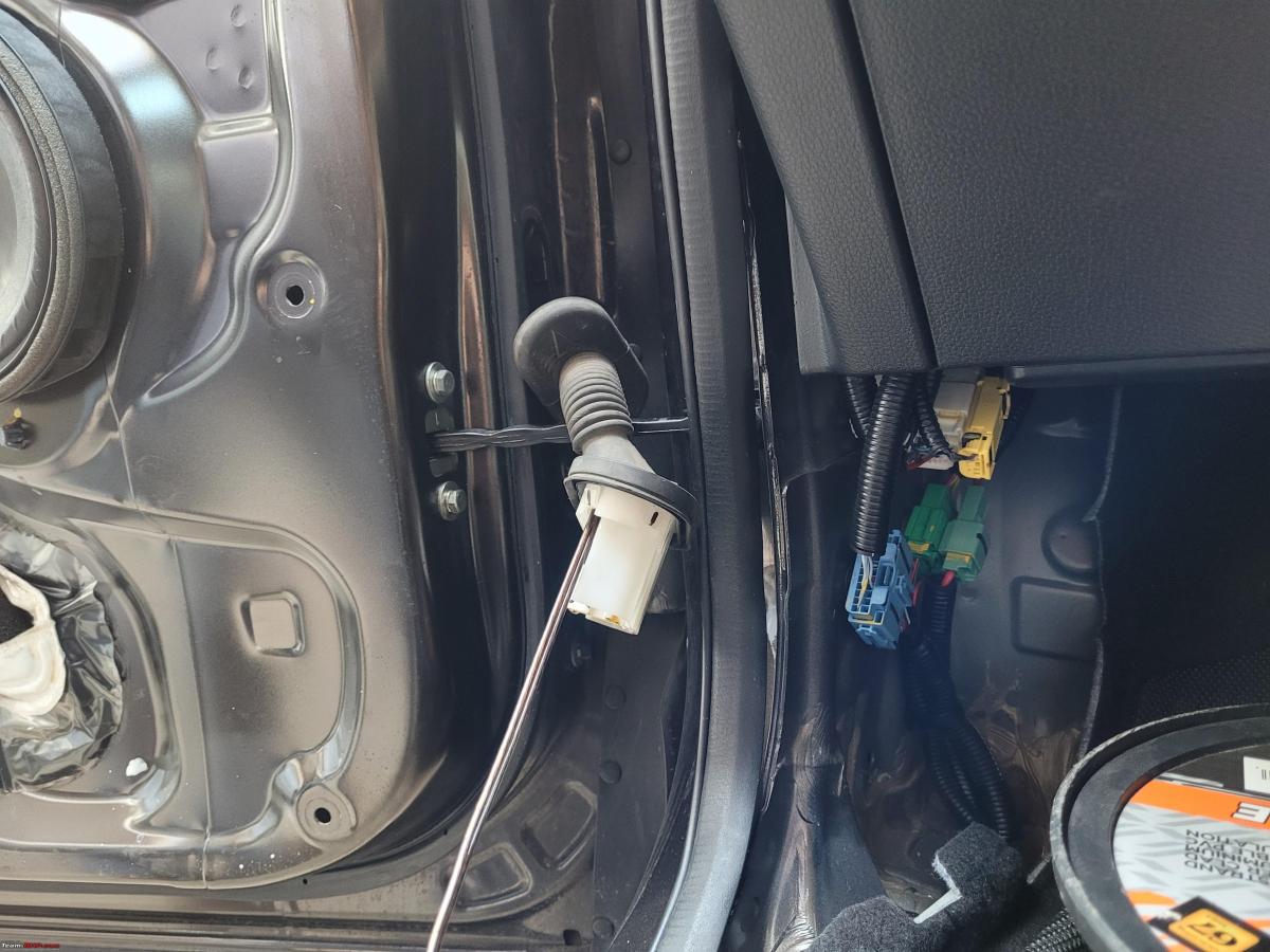

Few points to note:
  • OEM wires were only spliced, no cuts or joins
  • Front speakers were tapped as various onlines reviewers mentioned that the front signal is fuller than the rear
  • Dashboard was not touched. No risk of scratches etc.

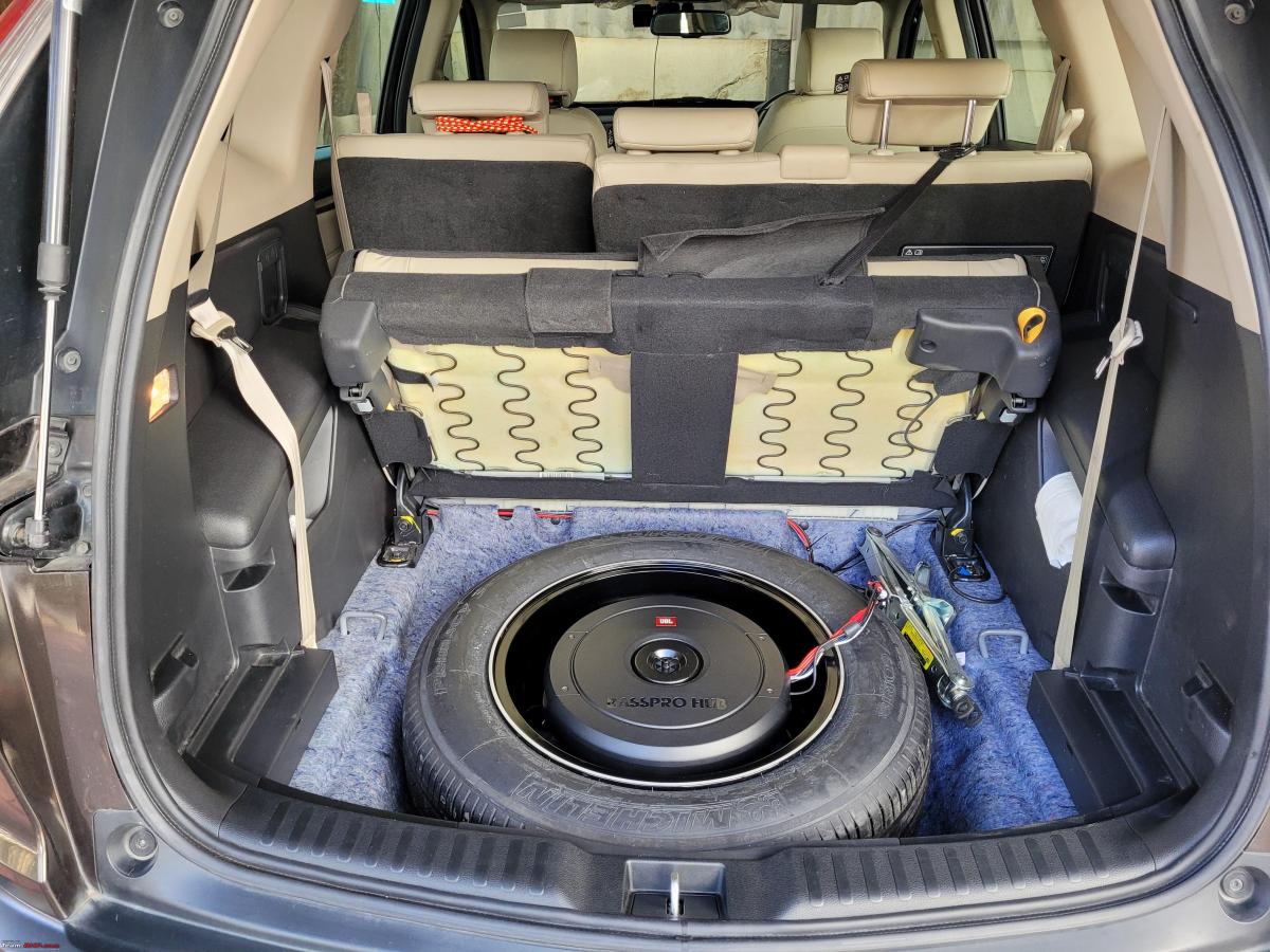

  • Boot space remains intact. The spare tyre had a foam cut out to hold some tools which have been kept in the hazard warning pouch
  • Battery fuse is adequately sized at 60A
  • Rear seat bolt was tapped for ground
  • No need for remote accessory fuse tap, since the high level speaker wires automatically turn the active sub on / off on car shutdown (takes about 60 seconds to shutdown).
  • No parked battery drain issue. Parked for a week and the car cranked without any issue (Btw the CRV is still on original 2019 battery, touchwood)
  • The speaker is easily removable with a wire plug and a long screw to access the tyre.
  • The whole installation took about 3 hours.

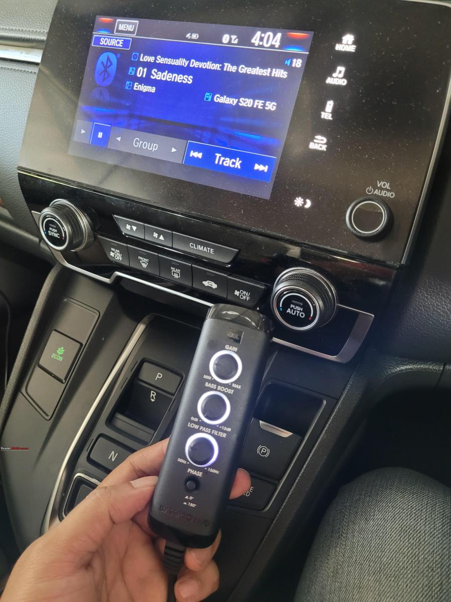

Once the installation was done, it was time to tune the sub. This involved polarity checking which Pankaj bhai expertly completed and had to swap a speaker connection. Once that is done, the setup is straightforward and as you can see in the final photo that I like my music on modest bass, but with a fuller sound. My preferred style is low - medium volume with a bass setting which 'just' completes the low frequencies. You really shouldn't be able to tell that there is a sub, if you know what I mean.
Believe me, this speaker really moves air and can go very loud to vibrate the entire car. One thing to note here that the OEM honda speaker signals had some extra boost between 100-200 Hz which I had to reduce using the equaliser (you can use the one from the car or within apps like spotify) and then use the subwoofer gain which created the linear crossover.
