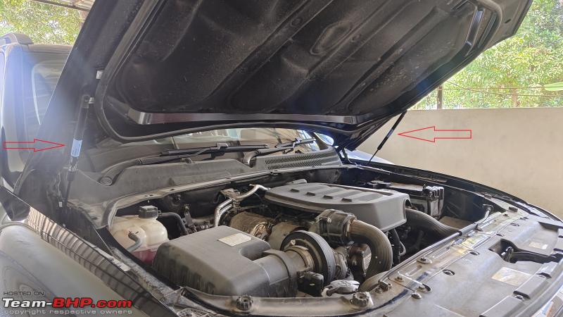

Last week, I purchased the "TRAC Hood Gas Strut Kit" for my Scorpio-N and decided to go the DIY route for the installation. Overall, the process was straightforward and only required some basic hand tools. However, I did face some difficulty placing the rivet in the correct spot.
The kit included two gas struts, all necessary mounting hardware, and six standard-sized rivets. I did have to buy a rivet gun for the installation.

The product functions well as intended. It automatically raises the hood as soon as you release the safety latch, similar to how a hatchback boot operates. Since this is a model-specific product designed for the Scorpio-N, it required no modifications to the fenders or extra drilling. It looks great and efficiently supports the heavy hood in an open position.

1. Since the gas strut kit puts continuous pressure on the safety hook bracket, I’m concerned it may wear down over time.
2. It makes a loud “THUD” sound when I pull the hood release lever.
3. I now have to use some force to close the hood.
