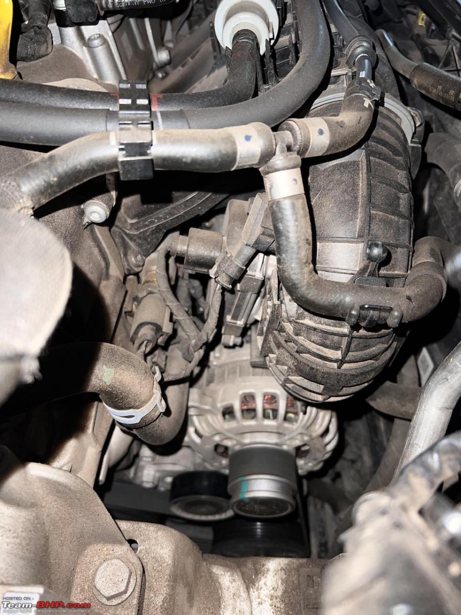

Installation was done at night so I do not have detailed instructions but the connection A to the MAP was the toughest since its located deep inside the gap between the intake and the cylinder block. I needed to use a long screw driver to unlock the connector and then remove it with two of my fingers which reached till there. And to fit the Racechip harness to the sensor I could again use only those two fingers to slide it into locking position. The gap you see in this image is where the palm must go in above the alternator, and you only get to peep into the area from above.
And to do this, I had to remove the vacuum pump off its mounting bolts to make space for the hand to be slid into the gap:
