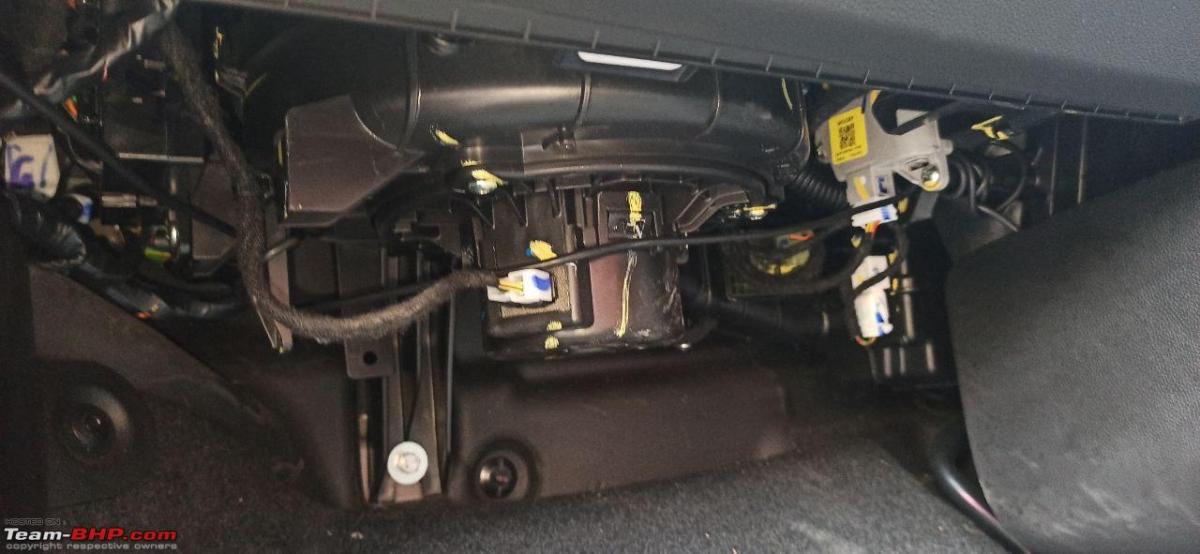

I routed the cable from the passenger side, as I had a spare USB port in the passenger footwell, next to the centre console.
Fixed the Dashcam below the fastag sticker and took the wire straight up to the roof lining.
Next, I pushed the wire inside the roof lining, it was easy and the wire is not visible at all.
I then hid (using the tool provided along with Dashcam) the wire inside the front left plastic, between the ridge where the soft roof lining meets the hard plastic panel.
The next step was important. I pushed the cable inside the plastic beading so that it gets neatly concealed. The cable had to be pushed a little more inside to ensure there were no bulges on the beading. I then used this beading to hide the cable so that I could run it down, to the bottom of the glovebox (and the cable stays hidden).
At the point where the beading meets the dashboard, the cable had to be brought out, concealed inside the dashboard plastic and then pushed back inside the beading.
I had decided to route the cable under the glove box, hence had to take it out from the beading and conceal it under the joint shown below (hi-lighted in yellow). I then hid it under the glove box, ensured it was a tight run and did not interfere with the passenger's feet. Ultimately I attached it to the USB port as shown below.
