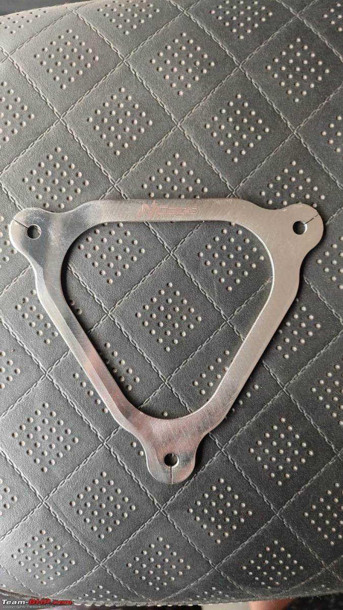

Yesterday I dropped in to BikeNBiker and installed the NGage air filer and the Ngage stage 2 plate. This is a genuine high-quality product. The filter requires oiling and I will most likely buy the cleaning and oiling kit from the Ngage website. This needs to be done every 8k-10k kms. The stage 2 plate is made of stainless steel or aluminium and is a high-quality product again. For the price of 4k with the stage 2 plate, I am very happy with the quality of the product and its performance so far. The BMC and K&N air filters cost more than double the price. Ngage also owns the MotoWings brands. This is the website for the product. It includes a maintenance document and a Dyno chart.

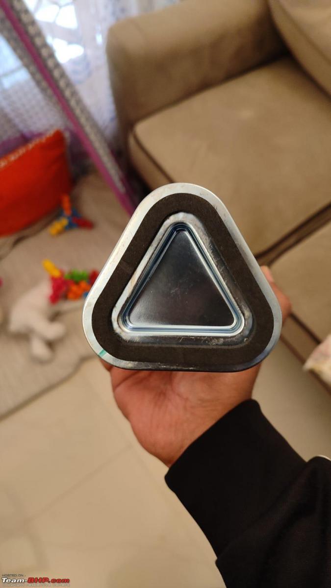

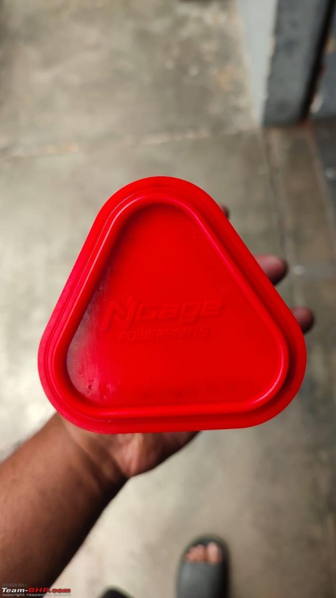

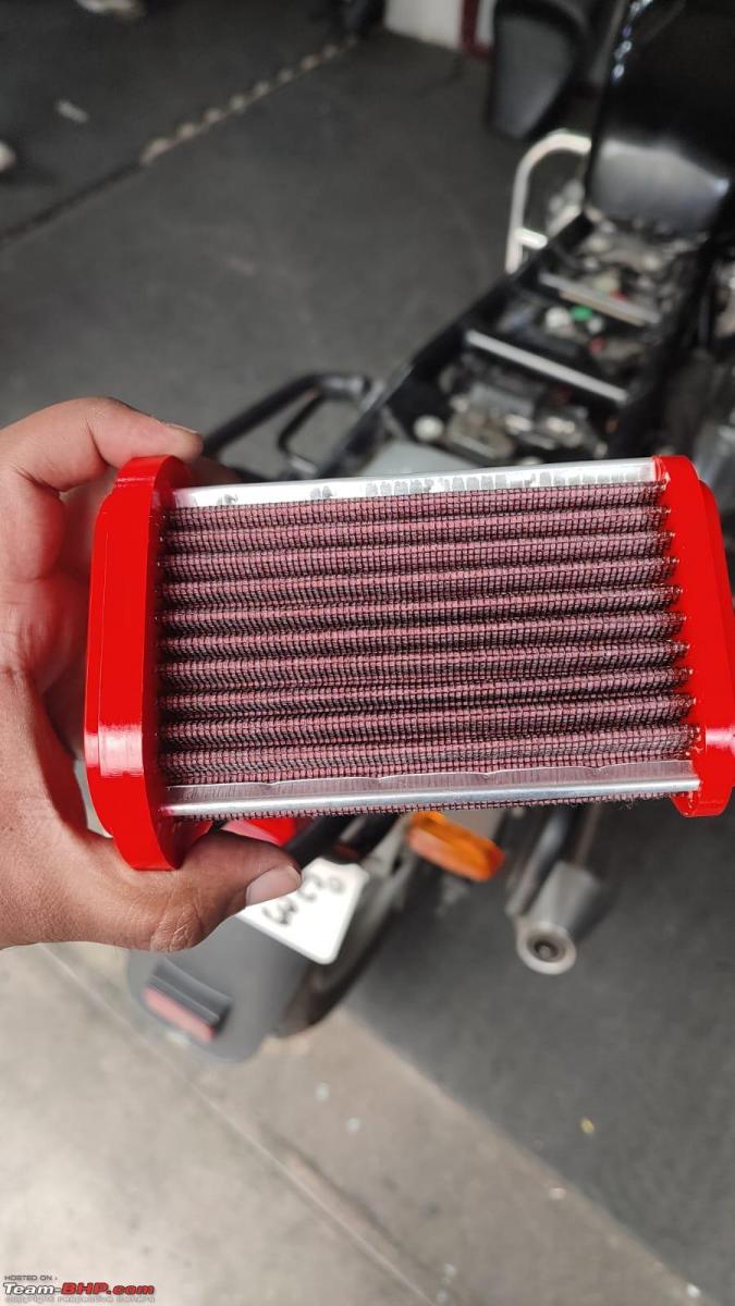

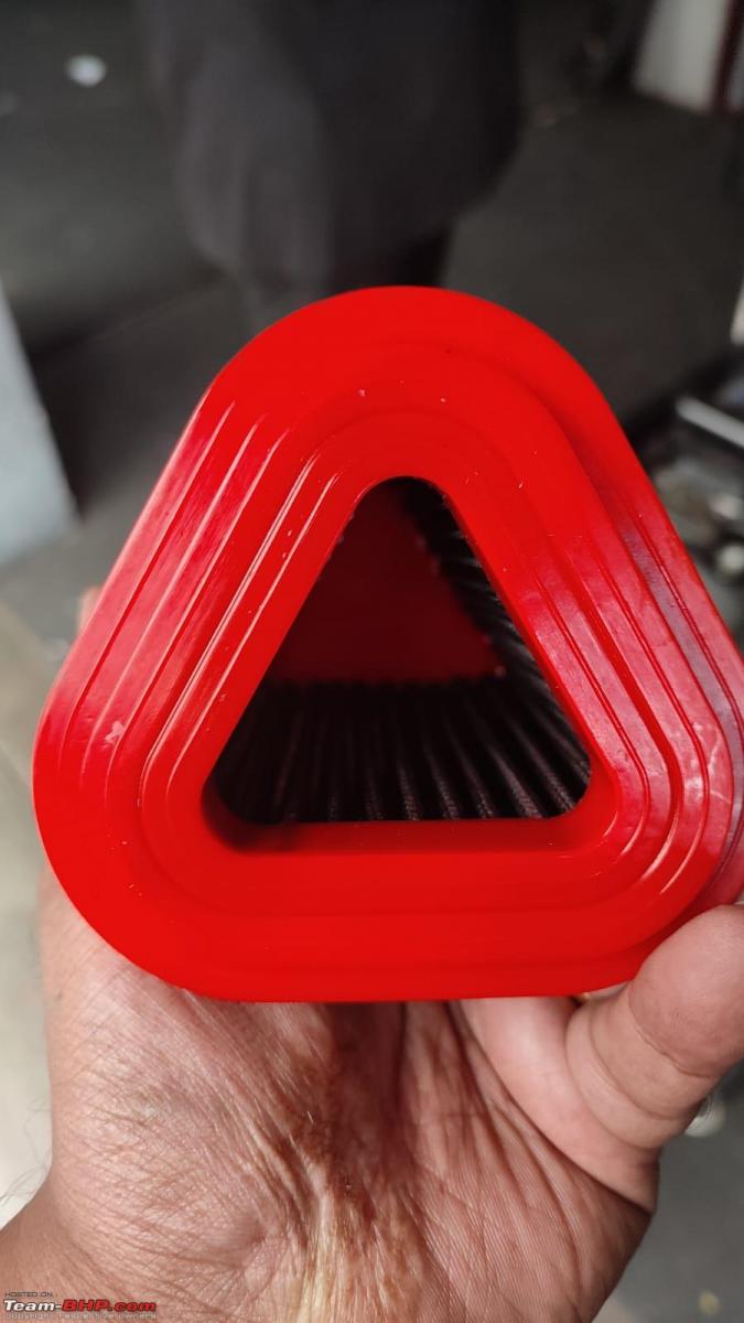

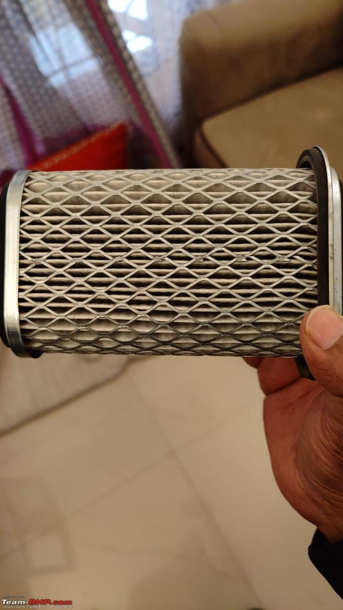

Attached are some pictures of the Ngage and the well-built stock filter for your reference. I tagged Schorl on Instagram but have yet to hear back from them. Seems like the owners of Schorl do not care about customer satisfaction or their brand. Thankfully Amazon is offering me a full refund.
Stock Filter - Rs 375 for the RE air filter for the Interceptor. High quality product, full metal body, foam inserts and well-finished metal joints. Right now being used a pen stand.
Ngage Filter - High quality air filter and 2 stage 2 plate. Great build quality, packaging and customer support. At Rs 3000 + 900 this is half the price of the BMC and K&N filters.
