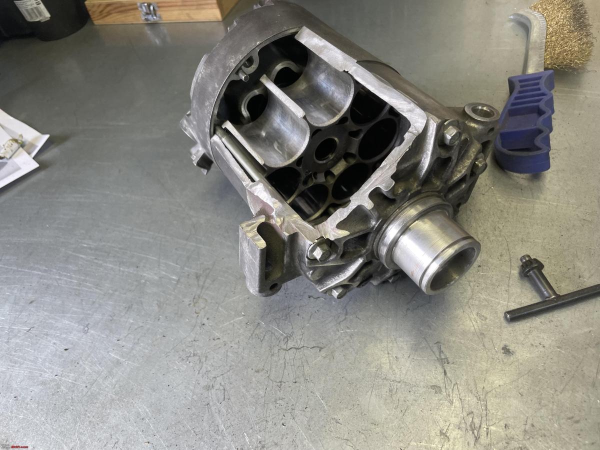

I also put the Ford Fiesta Cutaway compressor together. Cleaned it with various detergents and air-driven steel brushes.
These are just the three main body parts, I have left everything else off for now.
On Friday I am planning to take it to my favourite DIY sandblasting place.
So I carefully masked some bits and filled up some cavities that should not be blasted. All ready for some sandblasting!
