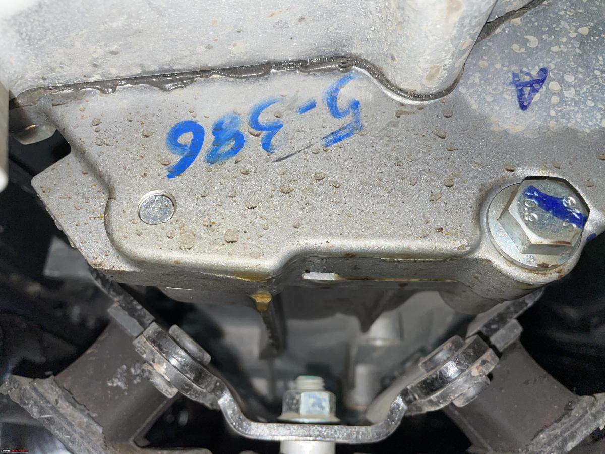

The next issue wasn’t detected by the service staff. I was looking at the underbody carefully (as I usually do at every service). I found some grease below the transmission.
Upon touching it I felt a huge lump of oil in the chassis.
Close inspection revealed the transmission gasket paste was improper and that was causing a leak. The transmission oil was not at appropriate levels and it was thanks to the 1000 km service interval that this issue was detected. If I drove more who knows what major damage the transmission would face.
