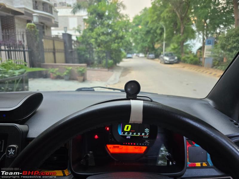

After Market Tachometer
Driving on all the winding, curvy roads that I get the opportunity to drive in; there were times where I was missing a tachometer. Only once I understand the power, I get in different rpm zones is when I can take a call on a remap. Along with it, have a better relationship with the Naturally Aspirated Engine Initial D style.
What is life if there is not the luxury and confusion of choices? Once again- The options at hand were: An Instrument Cluster Swap from the Top Variant. The only thing keeping me away was the green lights in the color scheme. An after market Tach! Did give the Ritz tachometer a try. Now, whether its the new ECUs that were not catching the signals, or my sheer luck- that it did not work!
Chinese Tachometers, should I or should I not was the pertinent question. Even tried a wifi OBD dongle to see if I can get accurate readings- there seemed to be a lag. Then, I came across this Malaysian Brand called Lufi. This seemed trustworthy enough as they have a site, and have a reasonable customer base in the Amreekas and the rest of the world. The other advantage- they have programmable lights, and a separate Shift light that you can procure and set to function the particular rpms you desire. Even you can program the lag, if any and tweak it.

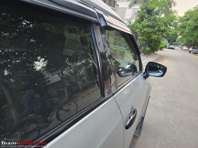

Gloss Black accents
ORVMS
Front door handles
IRVM

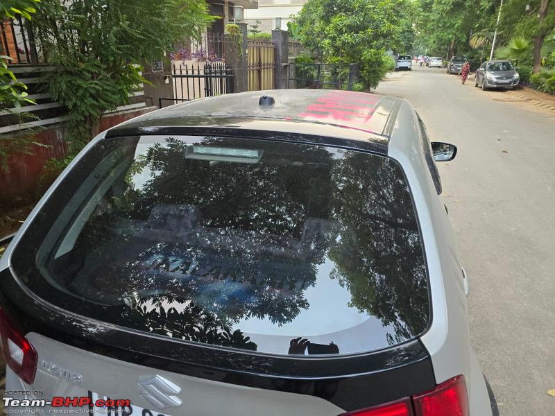

Some places on the boot.
Other acts of Randomness
Had some left over wrap from the roof, A pillars and B pillars wanted to say hello!
