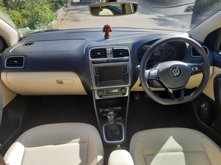

Overall, I have found it to be a well-built, comfortable car, with understated good looks, covering all the basics & providing a high level of driving pleasure in the city & on the highway. The engine & TC gearbox combination is responsive & provides the “fun-to-drive” factor.
