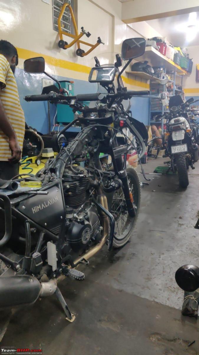

The removal of the fuel tank is necessary to route the throttle cable properly.

With the ODO at 14,600 Kms, I figured it was time to replace the control cables just for peace of mind. I called up the FNG I went to last time for the Oil Change (SKP Royal Enfield Bike Point) and enquired about the availability of spares. He had the clutch cable and said he could procure the throttle cable by evening, and asked me to come then.
The cables are pretty cheap and fairly simple to use. I've attached the pictures with the part numbers for anyone who wants to pick them up.
