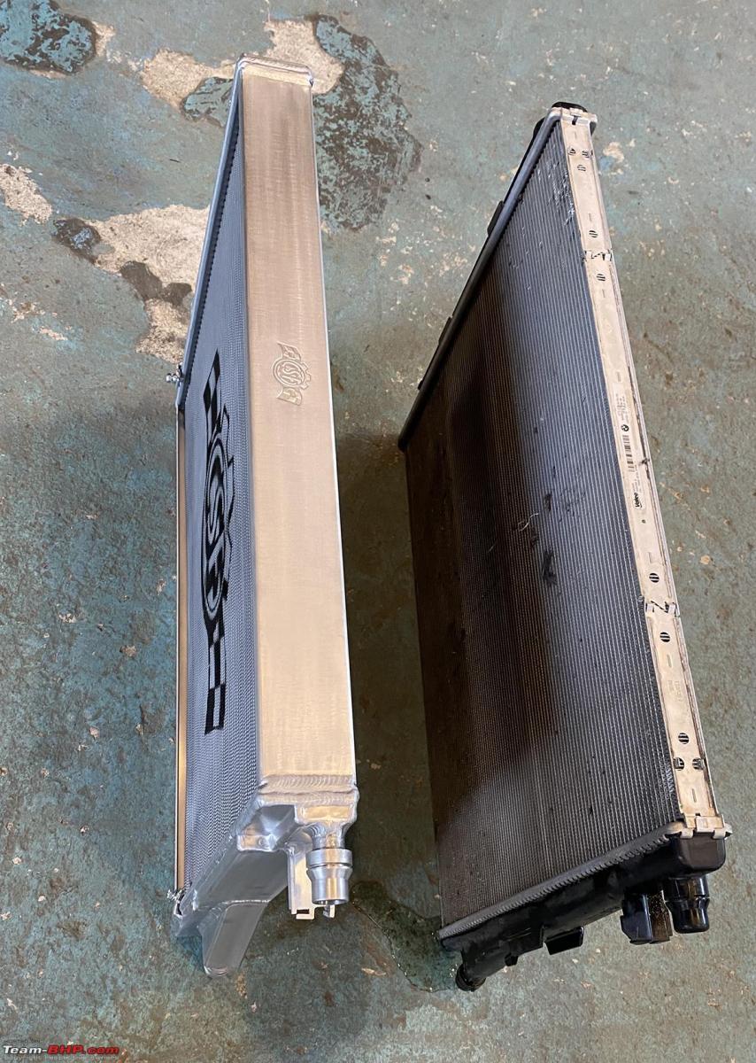

CSF Heat exchanger
With our weather conditions, more efficient cooling is always welcome. I got the CSF heat exchanger which has great reviews and significantly reduces intake air temperatures (IAT) and achieves much faster heat soak recovery (not just on the track but also on our hot and humid day-to-day drives). The best thing is that it is again a drop-in installation without much fuss.

The CSF heat exchanger
Comparing with the stock one
