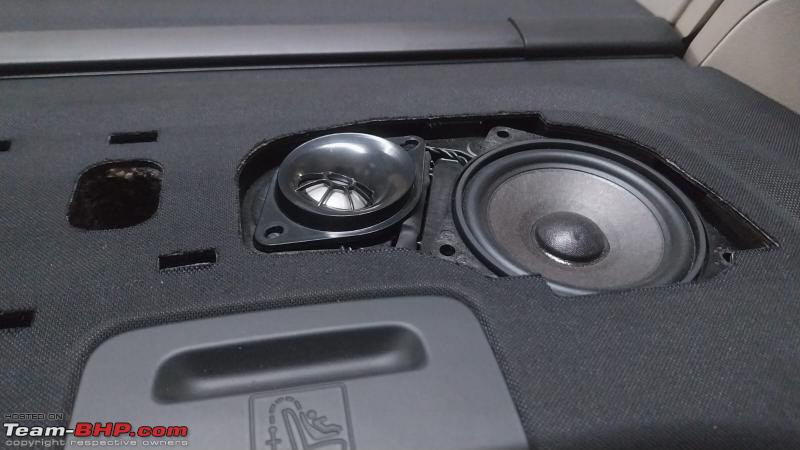

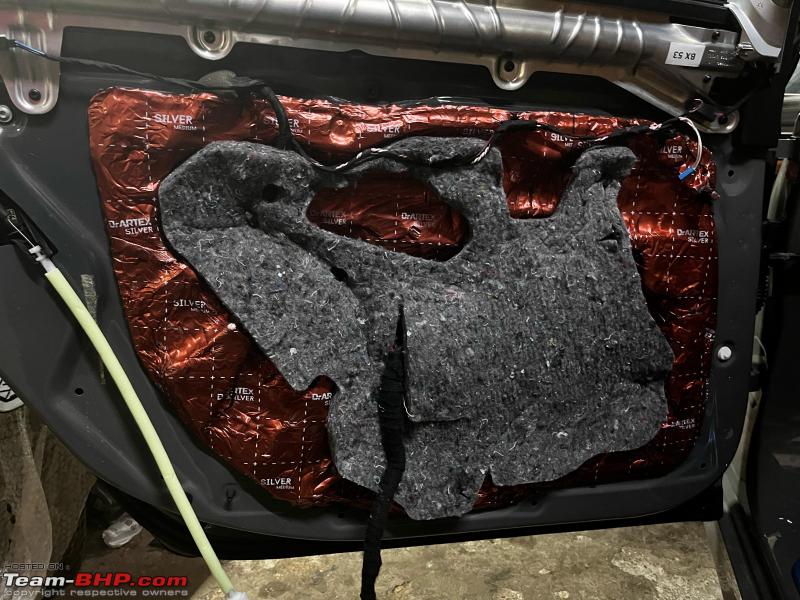

The Dr Artex Silver + Lace 15 combo was absolutely worth it. Even with the heft of the G12’s doors and padding, the added power demanded extra damping, and it’s made a clear difference in isolation and sound control.
There’s a lot of talk online about upgrading the amp—and yes, it does the trick for some—but I’ll be honest, the speakers have made an enormous difference. And I don’t think I’d have it any other way.

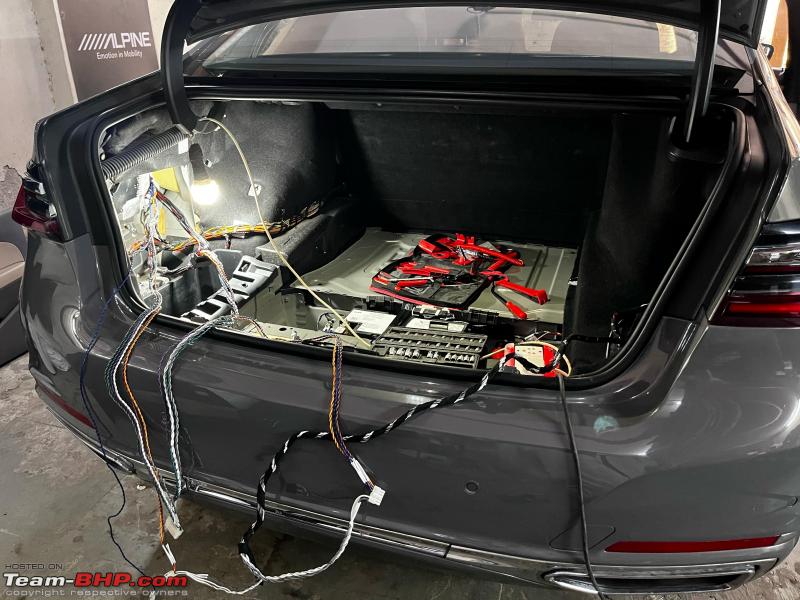

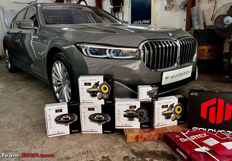

The kit of parts

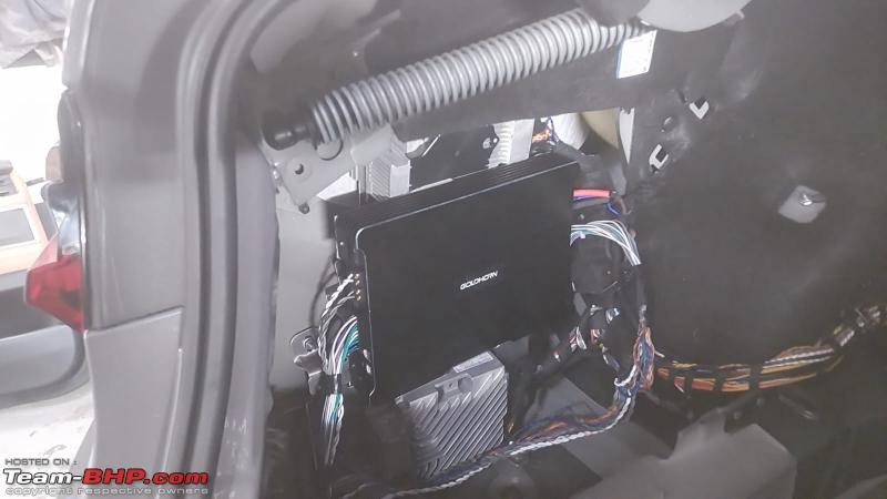

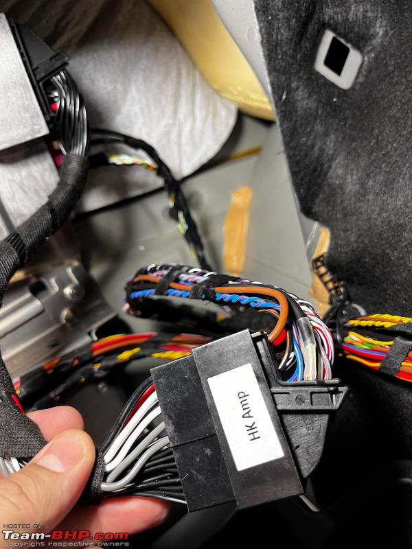

The home for the DSPA
The DSPA
The Harness
Installing the DSPA

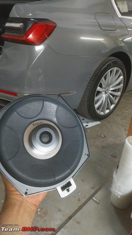

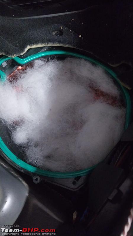

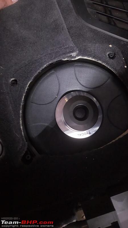

Installing the underfloor Subs
Damping the doors
