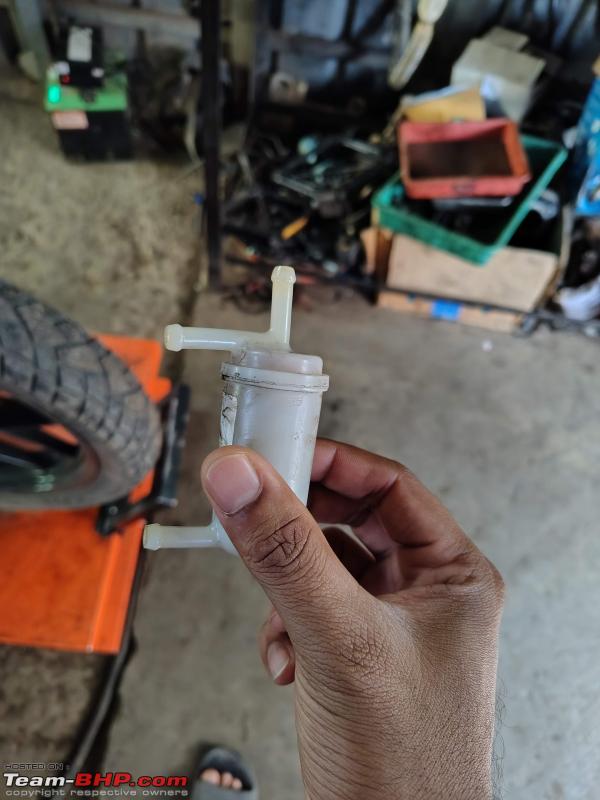

This is the dirtiest I have seen the air filter in a span of 5000km.
Surprisingly the fuel filter was very clean considering it was used for 8527km.
