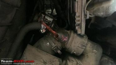

Apart from regular Nashik trips, not many trips were carried out. One afternoon, I reached my workplace and the car showed the overheating symbol. I let it cool and scanned it till then. No errors were found but the coolant tank was empty. Once the car cooled off, I topped it up with some water and checked for leakages. Found a coolant elbow near the radiator leaking. The cost was less than Rs. 1000, but had to search a lot to get it. It was replaced the same evening and since then the car has been good to go.

Leaking coolant elbow
