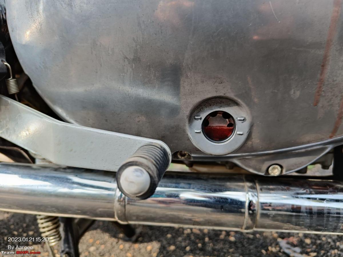

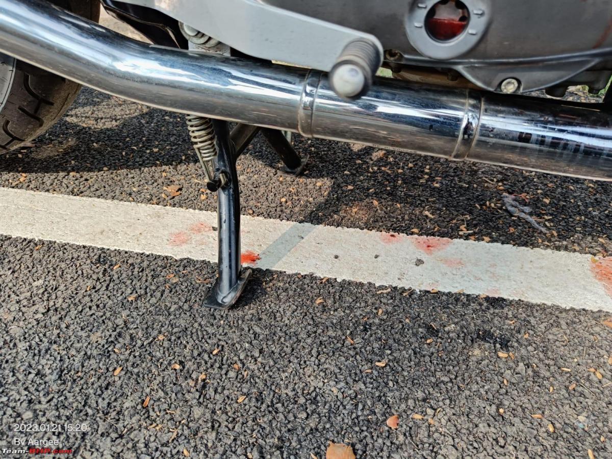

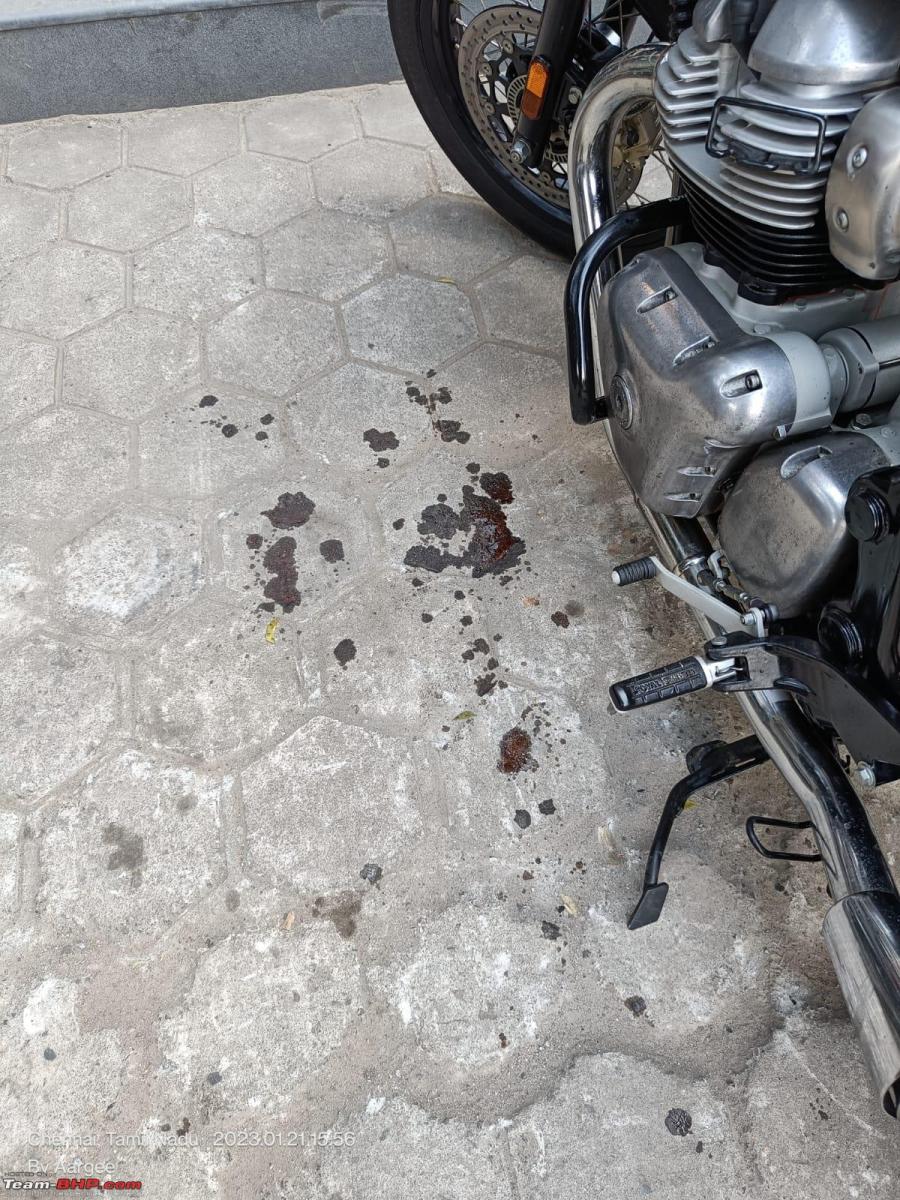

After parking this came as a little shocker:
And the first thing to pop in mind was whether ASC forgot to shut the fuel cap like this incident as RE ASC are notoriously full & technicians are under pressure to meet their daily targets. But on closer observation the oil level hasn't come down significantly. Which means, the spillage is not more than 50-75 ml or so + the oil level indicates that the bike can still be ridden:
Seems like the motorcycle is bleeding blood:

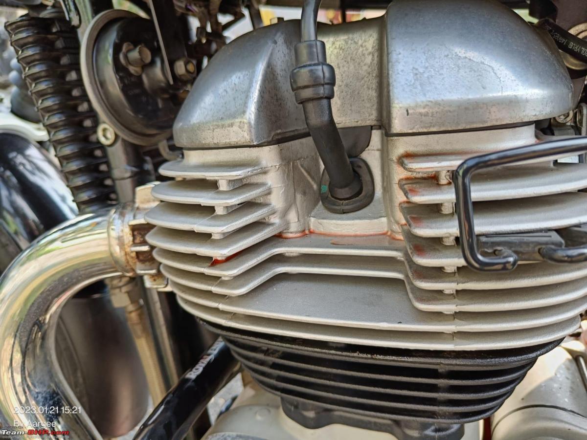

Rode back the bike to ASC immediately, told them the 3 issues on brakes, difficult engaging second gear & the oil spillage; technician immediately recognized the issue & attributed the oil spillage to O-Rings at cylinder head. He said it's perhaps due to the valve adjustment that was carried out. During that 5 minutes this was the loss of oil:
The gear issue was fixed by adjusting the gear shift linkage; Gear position indicator sensor was replaced under warranty for fixing the neutral light issue.
