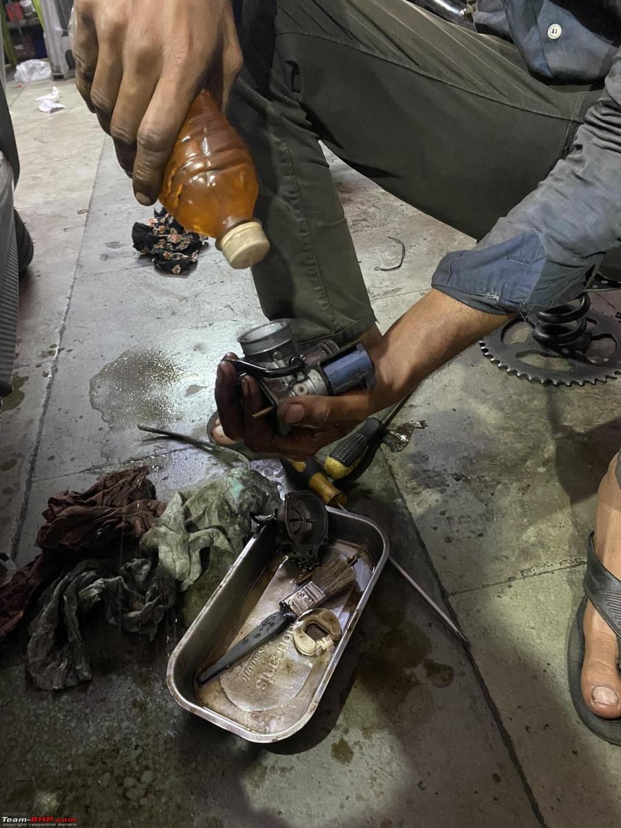

Taking the carb apart:
Cleaning with petrol (taken from my own tank). A lot of crap was removed
