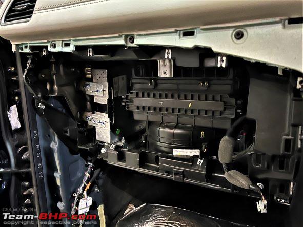

The SD memory card had to be installed next. I was carrying the SD card from October but somehow due to time constraints it could not installed. Today morning when I requested the Co-tek, he promised to do the job. The whole glove box and part of the panel had to be dismantled to insert the memory card. It is really funny why M&M cannot pre-install a memory card (costing Rs. 1 K - again this is M&M listed price) in a 20-25 Lakh car.
Here is a snap of the dismantled front panel. Notice the Silver Box on the extrme left. The slot for the memory card is between the Silver Box and the panel:
