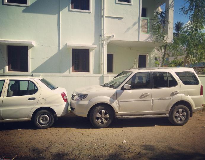

Now, I am in such a situation where I have no option but to park the car under the open sky. The weather is mostly extreme in summer and winter when the temperature goes above 45 in summer and drops below 7 in winter. The weather is mostly dry in this region.
I use a car cover most of the time but the car cover does not last more than a year due to the high heat. The heavy, waterproof cover saves the car in rain but accumulates moisture on the inside. Light car covers simply give up within 6 months because of the high heat. A temporary shade is not possible because of certain restrictions.
Therefore, I was thinking, "what can go wrong while keeping the car parked outdoor with or without a cover?" The possible answers:
  • Paint damage.
  • Plastic trim damage.
  • Rubber part (door seals etc.) damage.
  • Rusting?
I am concerned because I am looking to keep the car for a long time and the car is Tata Tigor 2019.
Looking for suggestions and advice.
