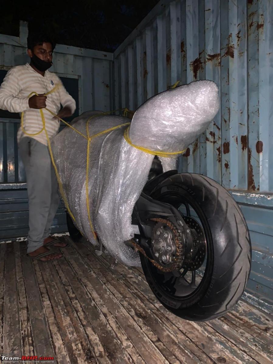

Bike ready for its move from Bangalore to Delhi
Bike loaded on the truck
