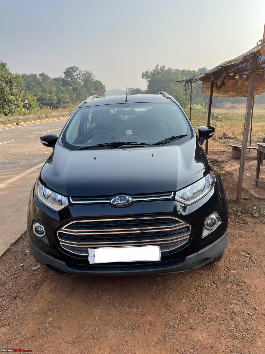

Fast forward to Dec’21 and at 39,313 kms (approx. 2k kms since 1st breakdown and 3k kms since Aug-21 engine service) - This time, we were returning from Goa to Pune driving on National Highway 66 near the town of Kankavli. At around 10:30 AM, I was at the steering wheel when suddenly, the “Engine Service Now” light appeared on the center console screen. Knowing this error from the 1st time, my sister advised me to keep the car in the left lane. As expected within 50 meters, the car engine died and the car halted. Efforts to restart the engine proved futile once again.
Given our experience from the 1st breakdown, we had availed the Ford Road Side Assistance Package (RSA), which unfortunately came to use so early on. Now, here starts our real ordeal which has incentivized me to post this experience on Team BHP.
Our first call to the RSA went at 10:49 AM from National Highway 66, and we had to wait until almost 1:30 PM just to get confirmation from RSA that the towing truck along with the custodian has been dispatched from site. If this was not already a long wait, the shocking news from Ford RSA was that the towing truck will take at least 3 more hrs to reach the destination. The towing truck finally arrived at 4:15 PM, almost after a 5.5 hr long wait on a National Highway without any assistance. Such SLAs for Road Side Assistances that too when officially availed from Ford, and on a National Highway is beyond my understanding and comprehension. The worst part about the quality of RSA is posted later here, for which I am still in a tussle with Ford RSA team.
Car picked up by RSA from NH66 (A painful sight for a petrolhead):
At 4:30 PM, our car was finally towed to Unique Ford Kolhapur and we had to arrange our personal transportation at our own expense to Pune.

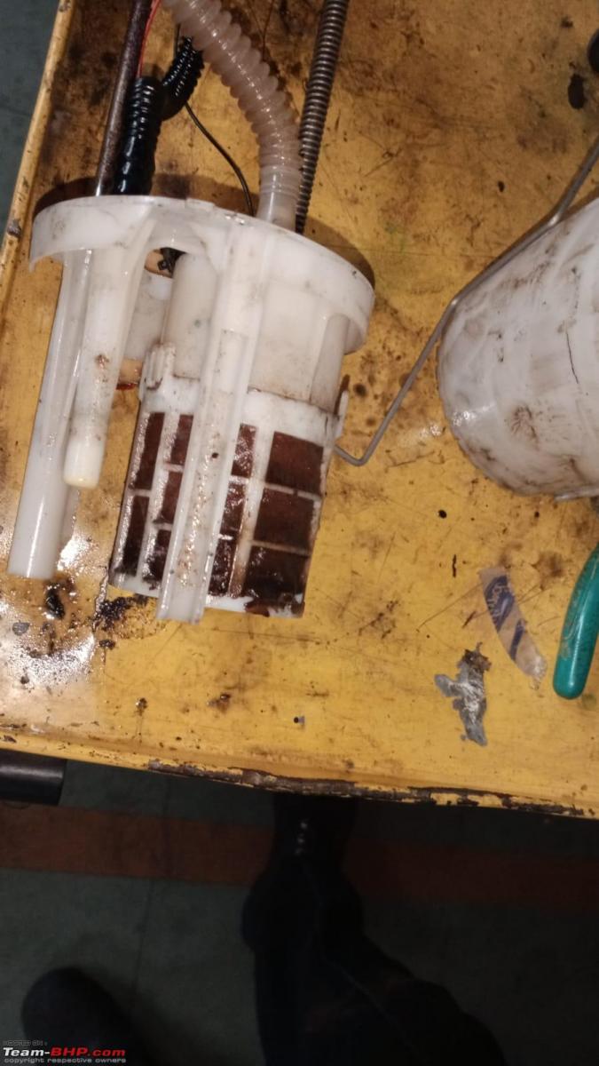

On 27th Dec, i.e. next day, we received a call from Unique Ford Kolhapur after they did an initial check of the car. They mentioned that OBD is showing 2 error codes:
  • P228C: Fuel Pressure Regulator 1 Exceeded Control Limits - Pressure Too Low AND.
  • P0093: Fuel system leak -large leak detected.
Clearly, something was wrong with the fuel system. When Unique Ford opened the fuel tank, they observed some debris leading to a clogged fuel filter. Unique Ford began the work on replacing the diesel filter and cleaning the fuel tank.
Fuel filter photos sent to us by Unique Ford Kolhapur:

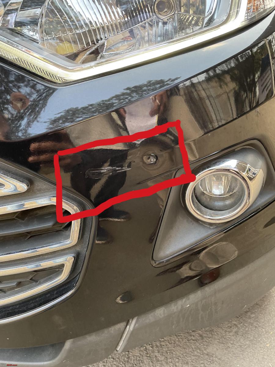

Getting back to the quality of RSA: When I went to take the delivery of my car at PPS Ford Pune, I observed a huge dent on the front bumper of the car, which Unique Ford claims was already present when RSA dropped the car at the dealership. Thankfully, I had clicked pictures of the car while the car was being lifted by the towing truck, and these came to use to prove that the front bumper was dent free when the car was handed over to the RSA. I am presently now in a tussle with Ford RSA, who till date hasn’t identified the ownership of the dent and who and how it will be fixed.
Huge dent on the front bumper incurred during pickup by Ford RSA:
