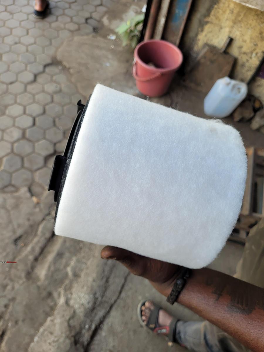

The air filter condition since last service:
The new air filter going in:
