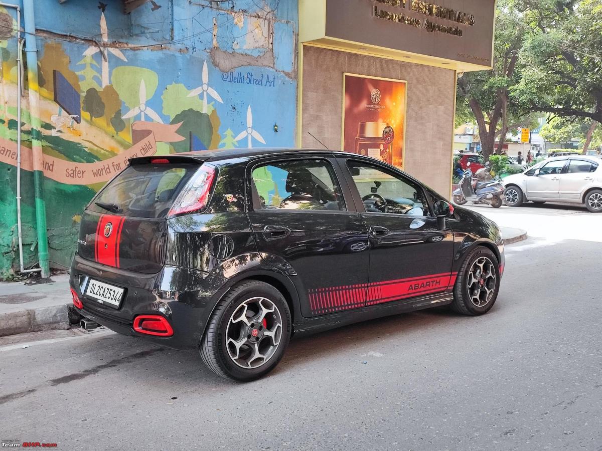

This is a thrill machine, and the privilege to own this masterpiece, one out of 357 odd ever made, is unparalleled. It's a piece of history dumped in a graveyard wherein the ghosts roar to keep the legacy alive. I am sure Fiat India has now completely forgotten that this existed.
Signing off with a few clicks below:
