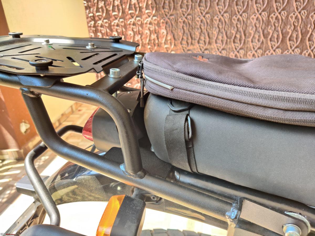

Delivery was fairly straightforward, as is the usual case now (Only Bikester Global hasn’t been able to sort this to date). The Rack and Box came in about 4-5 days from Haryana to Bangalore. The Box and the plate combined weigh a mere 4.2 Kgs. The Installation procedure is fairly straightforward and the plate is a direct bolt-on to the Zana Rack. Installation of the rack, however, phew, that was a task. I’m not sure whether it is Royal Enfield’s inconsistent welds or Zana’s (I think RE cause of past instances) but the rack was a bit too tight to fit on when using the rubber washers provided. Furthermore, replacing the rack at home proved challenging. While I managed to remove three of the four screws holding the rack, the fourth screw seemed to be stuck with an excessive amount of locktite, causing the screw head to strip. I had to take it to a welding shop to have it removed and had the rack and plate installed at my local FNG as it was nearby.
Stripped Screw Head
Then came another issue (definitely an issue with RE) is that the rack plate just wasn’t straight and was tilted to the left, This I was aware of earlier but was too prominent to ignore with the box mounted, so I used the two Rubber Washers from the Pillion Backrest Holes that this rack can accommodate and added it on the left side (Notice a small green object) to balance the rack.
Uneven Rack
Other than these issues, however, I guess you could say everything went well. I wasn’t a big fan of the lime green reflectors that Zana provides, so I picked up a few Red ones from Amazon.
