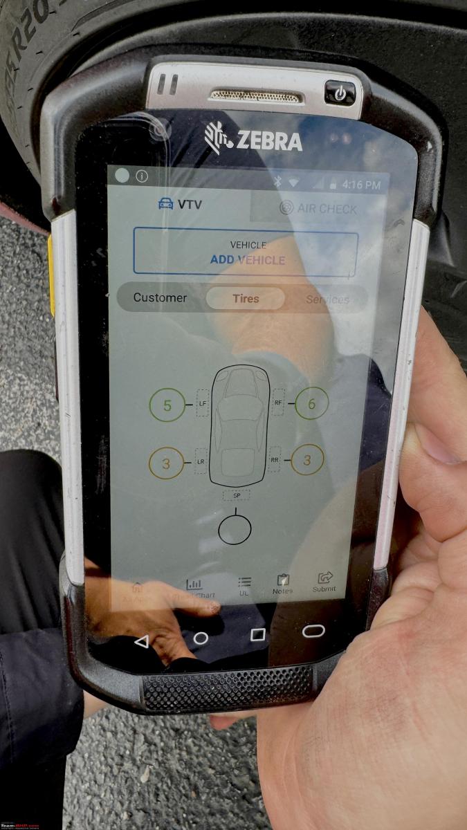

Just on a whim, I paid a visit to Discount Store to check if they would do a “FREE” rotation for my Tesla. First, they check the tires with a nice device which they put “behind” the tire to get the tread life.
While the treads look good from the outside, the results kind of shocked me as they came back with these numbers.
My car has now done 17,000 miles (27,000kms) in 18 months.
What it means is FL has 50% life, FR has 60% life, RR and RL has just 30% of life left.
Living in a land of rules does not help, Discount Tire does offer free rotations but, they refused to do it for tires at the current tread level-3/32th tread wear.
Here is an explanation of the tread wear. When the car comes out of the factory it’s at 10/32.
They recommend that I replace them with new tires at the earliest as the rolling resistance and stopping distance will decrease. I test them and see the car stop pretty good both with REGEN and with BRAKES for now.
Looks like my hard accelerations and Red Light Drag racing has cost me dearly. But, heck being an optimistic person, I turned this situation into a positive one. While I have come to terms that I need to replace them soon (Maybe in another 1k-2K miles) so until then, the car will remain in “SPORTS” mode and will now increase those heavy acceleration runs so I can run the tires to the ground.

Perhaps, you could do a Cross(X) rotation of the tyres to bring the better ones to the front and run them till you change? From the numbers, it looks like the rear has worn faster than the front. So this X pattern rotation might give you more life from the remaining tread!
I am sure there will be other shops that will do the rotation for a fee!
Here's what BHPian maranellored had to say about the matter:
A couple of things. Highly recommend getting a second opinion or checking the tread depth yourself. I've had my Tesla M3 AWD checked at America's Tire (Discount Tire in California) and their fancy gizmo was about 2/32" off the actual reading (operator error?)
To your point about tires wearing out faster, I've had to change the tires on an AWD Model 3 after about 34000 miles. This was after regular tire rotations every 6000 miles or so.
