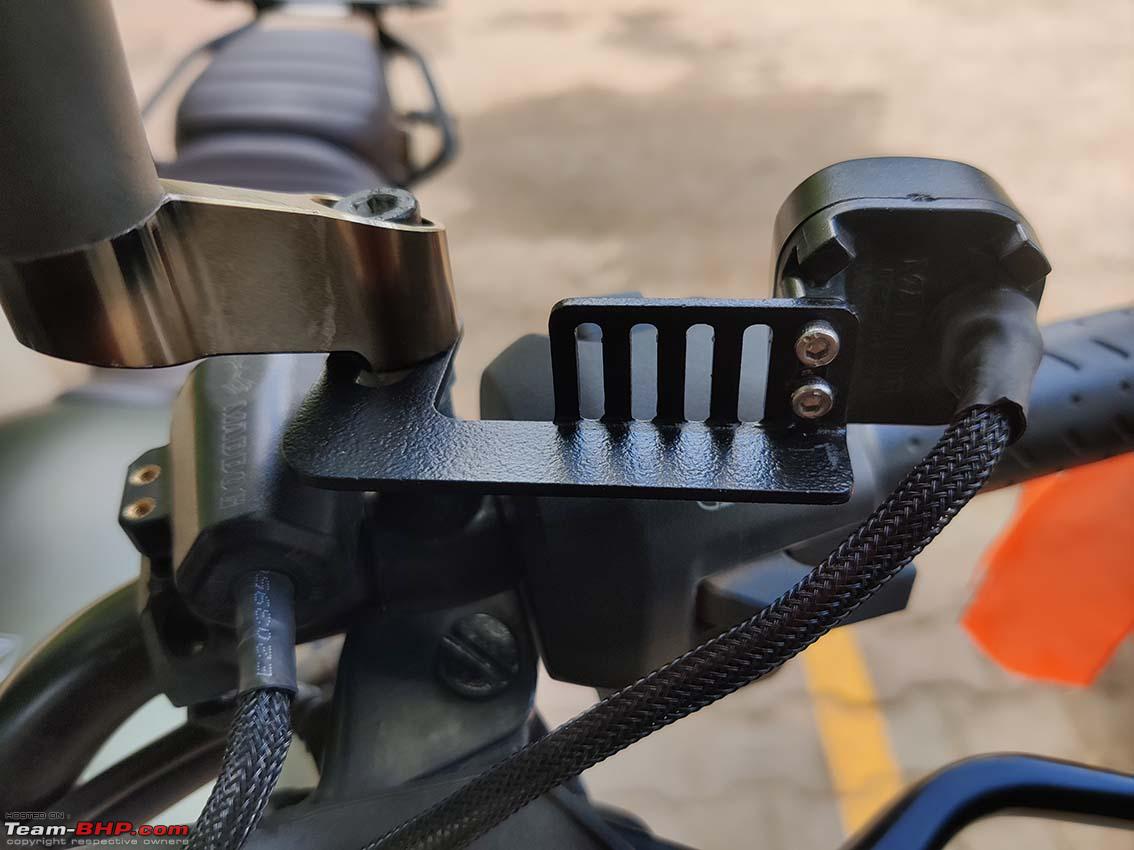

This push button switch also flashes the light at half-press and can be used to imitate the aux lights to flash. This was the main requirement for which the switch should be close to the thumb to easily operate.
BHPian nasirkaka recently shared this with other enthusiasts.
Made a simple clamp to bring the Maddog aux light switch more accessible and closer to the thumb. Maddog makes two types of switches both of which can be seen here. One is toggle type and less expensive, and the other one is push-button type and premium of the two. This push button switch also flashes the light at half-press and can be used to imitate the aux lights to flash. This was the main requirement for which the switch should be close to the thumb to easily operate.
I also had a pair of Rox handlebar risers from my previous bike. These are good quality 2" risers which allows 2 axis pivot control. This greatly increases the permutations allowing much finer control on the handlebar position possibility.
I thought to try them on the scrambler and they seem to fit just about fine. The handlebar position is very upright and standing and riding is easy as well.
The stance with the Rox handlebar riser. We can visibly see that the handlebar looks taller. All this is a personal setting of ergonomics and may not align with typical off-roading stance. My riding is more relaxed and the attempt is to make bike suited to what works for me.

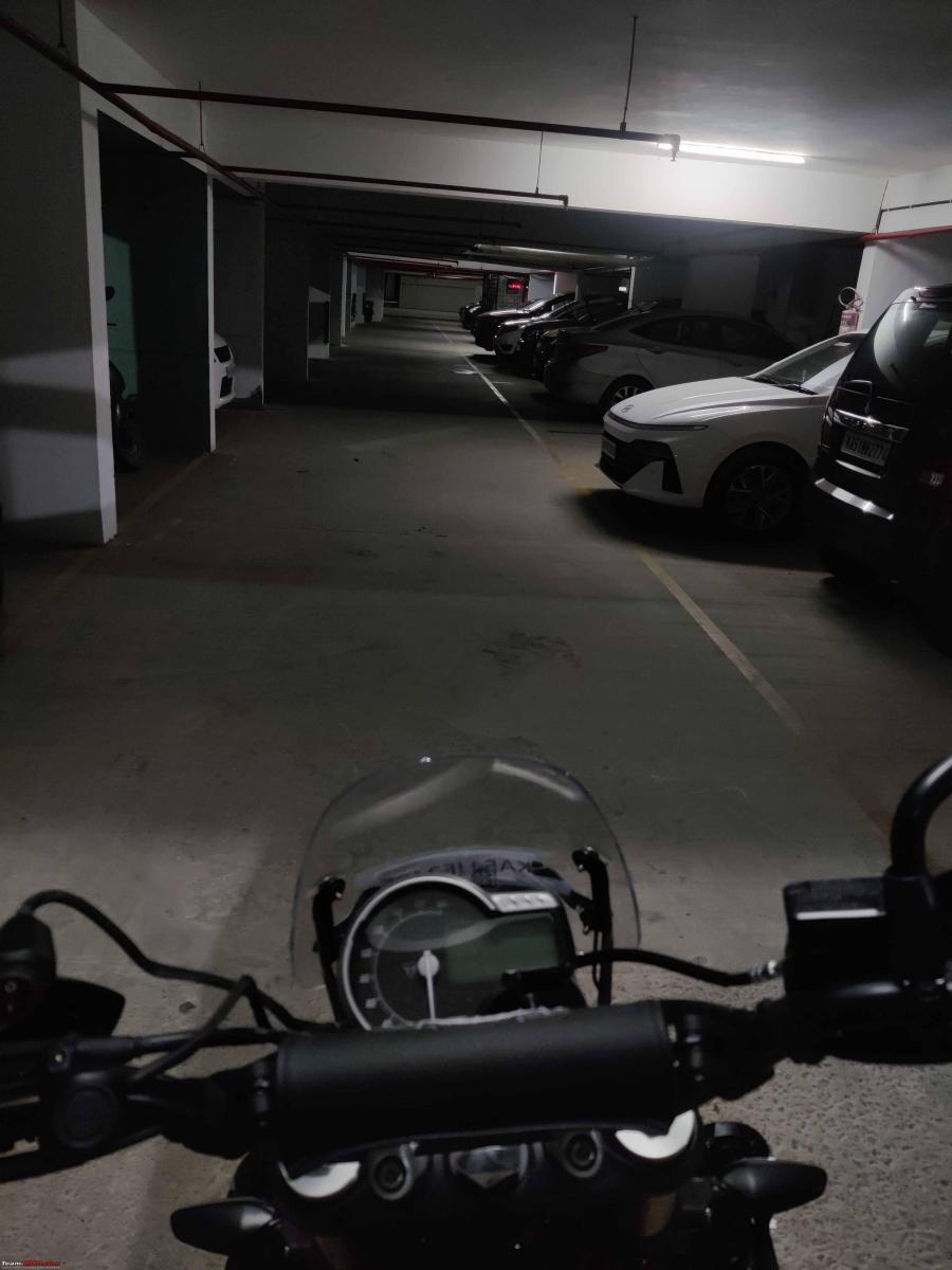

Stock headlight on the scrambler is very weak. I wanted to have two pair of aux lights for my usage. One pair (low wattage) is set closer to low beam pattern, so it does not bother oncoming traffic. Another pair (high wattage) is for highway/offroad usage, and is set closer to replicate the high beam pattern. I wanted to have one clamp to mount both the lights, so made one at my workplace using sheet metal fabrication. Two separate maddog wiring harnesses were used with relay, fuse etc along with their independent control switch. During the process it was observed that there is not much space under the tank or under the seat for the harness and relays and one should be careful to route and secure the cables.
The sheet metal fork clamp CAD
Fabrication in process
Wiring harness
Pair of aux lights with fabricated metal clamp
The following images show the light throw with and without aux lights. The exposure values were locked to get a fair idea of the illumination.
No lights
Low beam on
High beam on
Small aux lights on
Large aux lights on

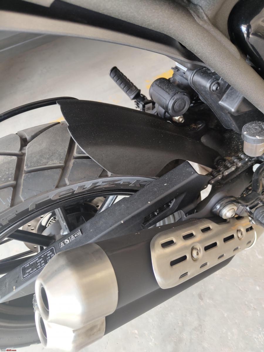

FRONT MUDGUARD:
I had opted for raised mudguard but that comes with a small tyre hugger for the front. The setup was throwing a lot of dirt from the road on the ride and the rider. I replaced the small hugger mudguard on the front with stock mudguard.
