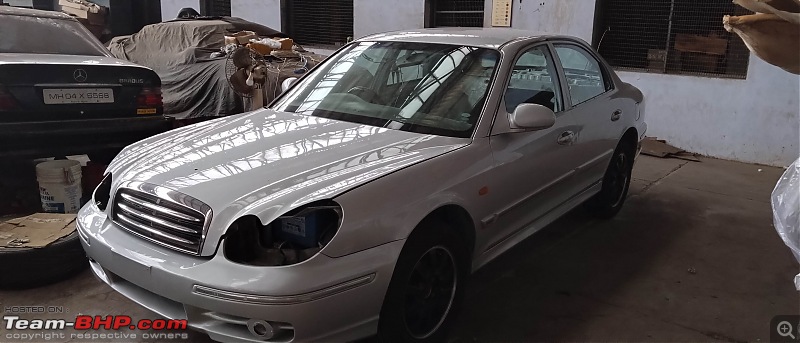

The windows are back on the car, as are the tail lights.
We've used the fresh moulding and the soft sealant strips that go above and below the windscreen. Thanks to the elaborate part diagrams, I've ordered everything I deemed necessary to fix the glass. I surprised my mechanic because he didn't expect the strips that go under the glass.
He found that the front glass didn't sit quite right (we hadn't taken it off all this time) so he got that removed and installed again with appropriate bonding solution. This was done by professionals and cost me ₹2,800. Quite expensive if you ask me. It took an hour to do.

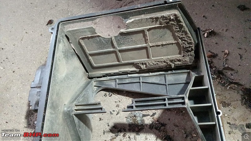

The AC recirculation flap has been partly damaged by rodents.
This happened before I purchased the car (I can say this with confidence because the Sonata has been under the watchful eye of 4 cats since I drove it into the factory). Hyundai doesn't have a separate part number for this assembly so my mechanic will attempt some fix by himself. It's not a big problem - there's no pressure, no heat, and no fluids involved, so anything will do basically.
There was a similar-sized hole in the old air filter which has since been replaced.
