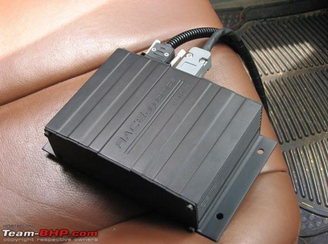

  • Power chips and boxes:
    As simple to install as plug-and-play; in as little as five minutes you can shave upto three seconds from your 0 – 100 acceleration time. Most diesel engines are electronically controlled and a power box will adjust certain control parameters to significantly improve performance. Adding a better intake filter and a free flow exhaust will further improve the performance of your chipped diesel.
