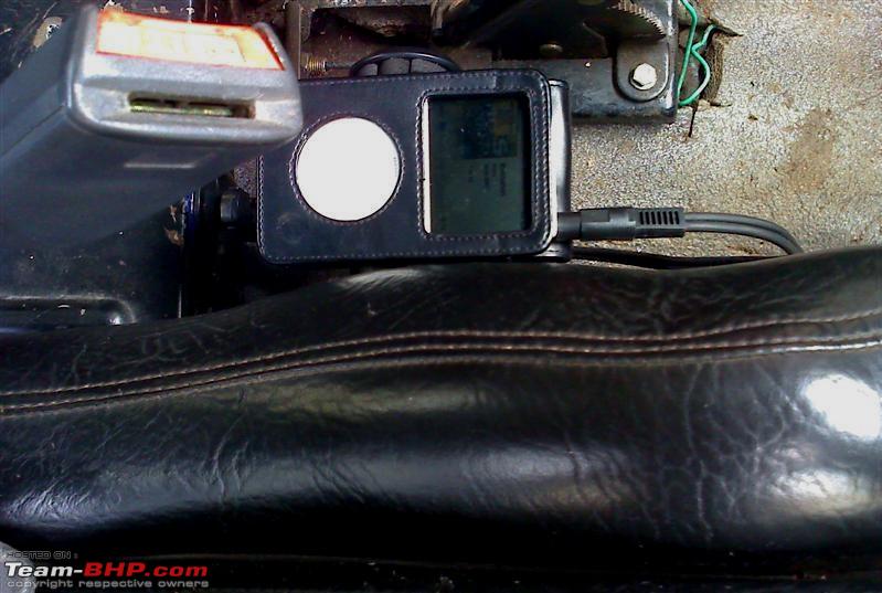

The cheapest ICE you can have. MP3 player (could be your smart phone, thus no cost), mobile phone holder (150 bucks), AUX cable (100 bucks), two old Pioneer speakers, a cheap amplifier and a custom made boom box (500 - 2000 bucks):

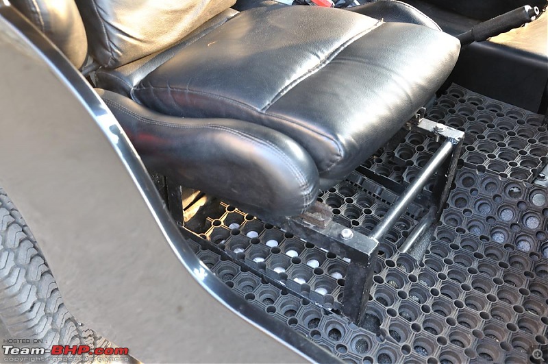

House mats double up as floor mats. This design is very easy to source in India, and is great for off-roading:

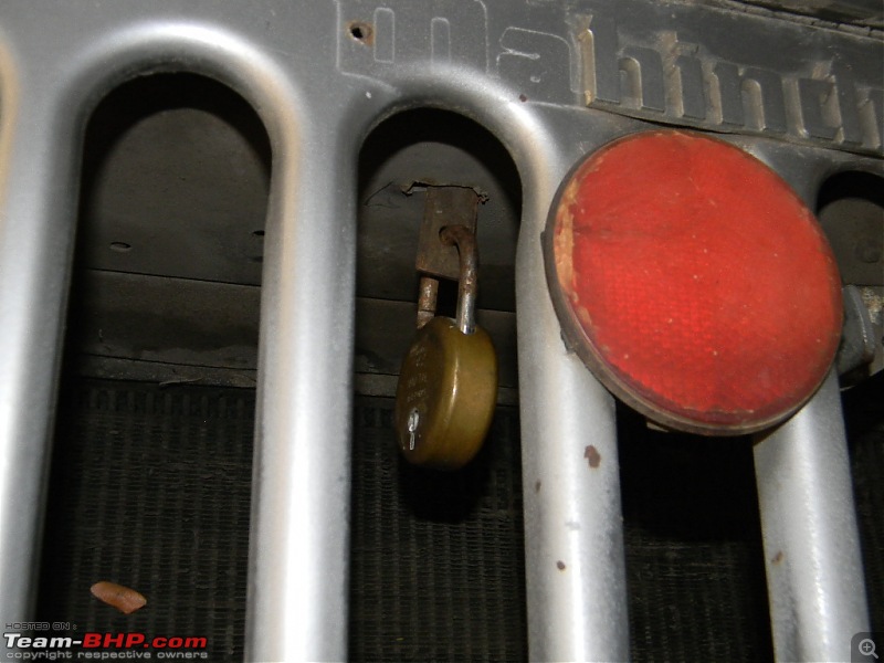

2 MM 540 bonnet lock

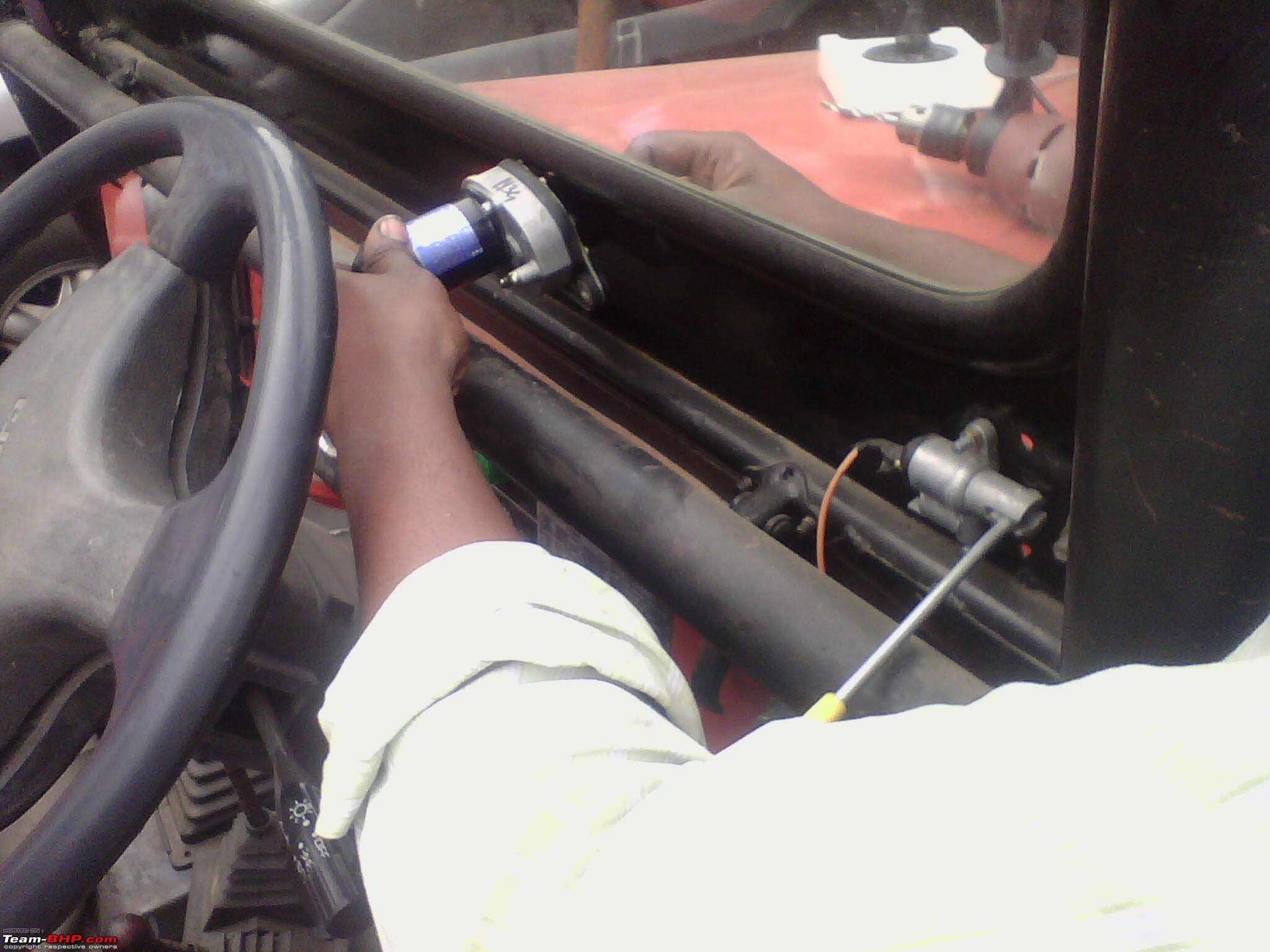

9) Horn switch - this was a fun mod, loved the way truckers honk without moving their palms far away from the wheel - this position is very ergonomic for right palm index+middle fingers (pic angle not correct) - no need to take hands off wheel in city traffic - 100~Rs for the switch. (no earth wire reqd since its mounted on metal frame)

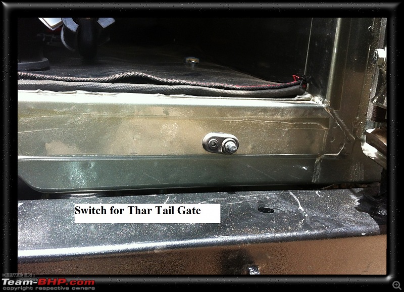

A friends gypsy with fire extinguisher, tail gate extra lock,
