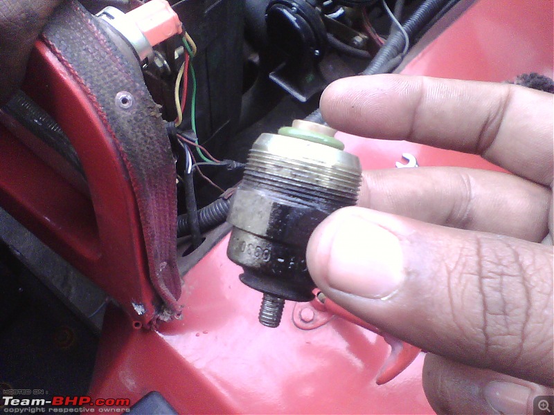

Aara Dada... As if having a key was fool proof ... During Dr.Madhus (black 540) jeep restoration I lost the key in the pitch dark area of the welder shop. Took 1 screw driver and removed the switch assy and made the wires direct and drove the jeep for 2 days before I could bring the spare key from docs home.
Stage 2 complete:
Samu, you would be surprised the this operation took only 10 mins max. See the position of the spanner used by my mech.
This side with the tiny little thread is what is visible from outside and the wire connects here.
Side view
Bottom where the actual moving part sits
Actual switch with a moving spring in it
FIP without the solenoid in it - Ps, there was tiny amount of dust visible in here, mech quickly pumped the filter and diesel gushed out taking out the dust along with it.
The weakest part of the whole topic here
- Mech explained (roughly) that if this spring fails/expands then the flow of diesel will restrict and lead to a choked engine. Dhabhar sir - please explain in your words...
Samu - this is the exact position in which the solenoid came out, did not need a box spanner, nor did any other filter/pipe came out of the way. Only the engine breather pipe was removed...
Now, for a video how to start/stop my jeep.
...fin...
Hi,
There is another scenario which you should consider. If you park your vehicle on an incline, step out for a recce, and the vehicle rolls, it will start up and run away from you! (Of course there are ways round it).
Thiefproofing a Jeep is difficult.
