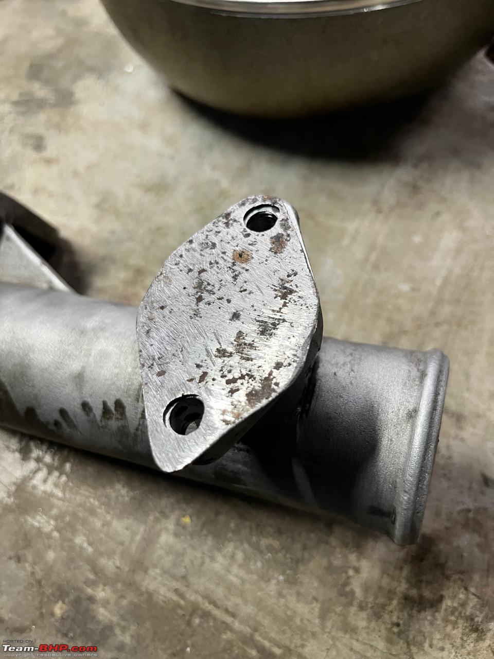

Meanwhile, I decided to move the EGR blanking plate from the exhaust manifold towards the intake side. The rationales were:
1. The plate would get way too hotter placed at the exhaust side and hence melt probably? At the intake side, the plate would stay cool because any exhaust hot gas would be colder comparatively, and there's EGR cooler too.
2. Blocking right at the intake implies that all the cold air from the intercooler finds its way only and directly into the intake manifold, instead of travelling towards the EGR side and perhaps losing some boost pressure there.
Thar CRDe: Improving its low-end torque-whatsapp-image-20250423-4.49.42-pm.jpeg

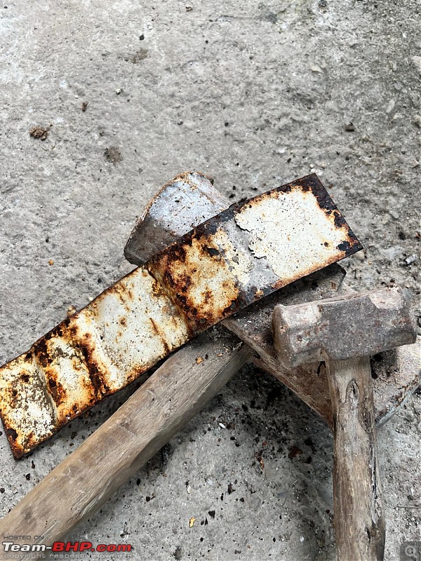

I also fabricated the EGR blocking plate myself because the previous one was too crude and lazy-looking. This time I put some effort. The following pictures will tell the story:
Thar CRDe: Improving its low-end torque-whatsapp-image-20250423-4.09.17-pm2.jpeg
A scrap of iron sheet (5 mm thick) ↑↑
Thar CRDe: Improving its low-end torque-whatsapp-image-20250423-4.09.17-pm3.jpeg

Thar CRDe: Improving its low-end torque-whatsapp-image-20250423-4.09.17-pm8.jpeg
Looks like it fits ↑↑
Oh, by the way, I took extra care to sand down the edges so that it isn't sharp and hurts me during maintenance, installation, etc. or damages automotive wiring.
Lastly, before I install the plate in, I have to ask a question to the experts here.
Should I drill a small hole in the middle of the plate?
Why? Because I have seen that done in many after market blanking plates. They claim that it keeps the engine light from turning on (the emission malfunction light). Are there other benefits to letting in a little bit of exhaust gas in? Personally, I like it completely sealed such that the engine gets to breathe only pure cold air at all times. Please do drop some views, thanks.

I had a blanking plate made out of aluminium that the engine swallowed.old car.
EGT was extremely high and it probably melted and went straight through. Never had issues though.
But throughout my experiments with blocking egr, whether a blanking plate on one of the egr plumbing sides or disconnecting the egr valve vacuum line, I always got a CEL after some time. Since your ECU is remapped, get them to code out the EGR function if it has a ECU controlled valve. Else this will throw errors.
