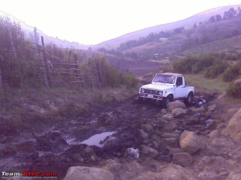

An update on the 'crawler gear set' after the Munnar OTR
Off-Road Trails(4WD):
Now I understand what 'crawling' really means. With a stock Gypsy, you can NEVER crawl -- both up and down the slope.
With my crawler gears, while coming down slopes, it was just moving literally inch by inchin 4L-1 and no ABC, again something that can't be done with a stock Gypsy.
While going up the slopes, I had to literally just touch the accelerator with toe and it was crawling up effortlessly. So inclines where earlier I had to use rev & use momentum I just crawled through slowly and without jumping around.
Now, if I want to go back to my Stock Gypsy way of driving over trails, I have to use 4L-3rd gear. There were sections where I did the trail in 4L- 4/5 gears -- probably the first time I have done so.
To give a perspective, here are 2 pictures (courtesy Dwaraka).
In both of these, with stock gypsy, one has to use 'momentum'. With the 'crawler gears' I was literally moving 'inch by inch' over this terrain.

The top speed has come down now (could touch a max of 110 only now). BUT, the in gear acceleration is WICKED. I can be on highway behind traffic in 3rd/4th gear and literally take off without changing gears.
While coming back, between Dharmapuri/Hosur, I was really enjoying this acceleration bursts and zipping through the traffic. I overtook EVERY vehicle -- including skodas, sumos, qualis, esteems, etc etc.. The reason -- not the top speed but the ease of acceleration and within no time I was touching 80km/h in 3rd/4th gear before hitting another traffic pocket for overtaking.
Best part:
NO drop in FE figures. We had 3 gypsies all through 1000kms and we all go literally same mileage of ~12 kmpl. So needless to say that I am very happy with great on road torque/acceleration, no drop in FE & exceptional off-road capabilities.
