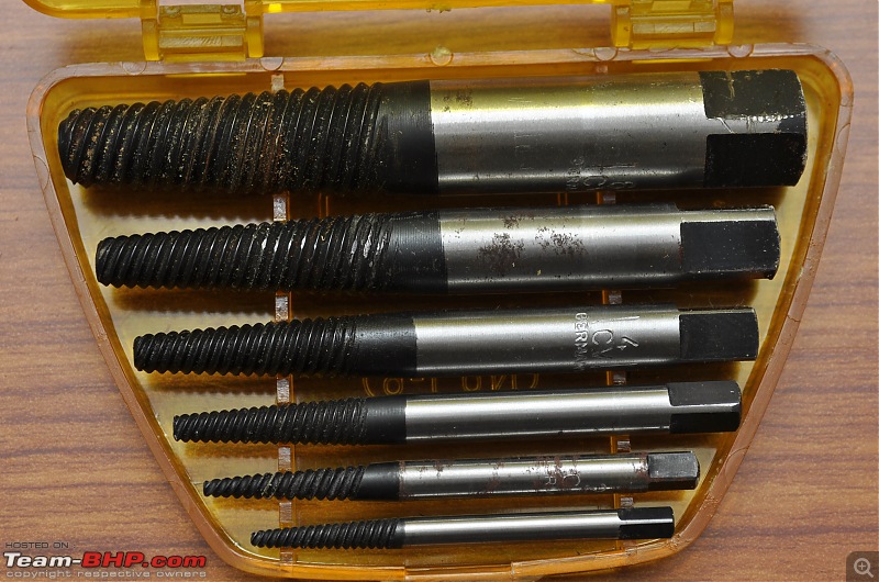

Re: Offroad Tools Thread
Though not a part of Off Road Tool Kit, an important piece in my collection.
Screw Extractor : Any broken bolt / stud or a bolt (Job) with damaged head can be removed with this. Drill a small hole upto reasonable depth in the centre of the screw (Job) to be extracted. Start inserting suitable extractor which will cut threads as it passes. However, the rotation of the extractor is reverse to the rotation of the job. Extractor is tapered and when it cannot sqeeze itself any further, the job starts rotating and in the process is removed.
I have used it successfully when all other means have failed.

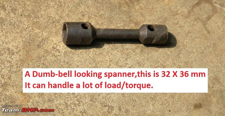

What is the size of the wheel bearing locknut socket? My mechanic used a chisel and hammer to remove it and tighten it during hub greasing.
I bought a socket yesterday for Rs 150 and its written 52 on that.
ArunV is offline
Old 3rd October 2013, 20:06   #89
Posts: 2,615
Thanked: 3,038 Times
I think that it is 32mm or less, as I have opened it up and I do not have > 32mm socket.
Aroy is offline
Old 3rd October 2013, 20:50   #90
Posts: 1,200
Thanked: 885 Times
As far as I remember ( because have the spanners for long time & as I know which one in the kit fits where , have forgotten the size in mm )
But, the check nut spanner [rear FFRA ,front hub is 55 mm )
And the rear SFRA [old] was 36 mm ( I discarded the old SFRA long back, so need to find the Nut in the store)
But on the safer side take one nut with you & buy a piece . The 36 will be in socket & the 55 (or 52 whatever is there) will come in a box (pipe) fashion.
But always be respectful if you are using heavy spanners along with some " good " torque.... I have ripped off the fiat axle thread section from the axle once
