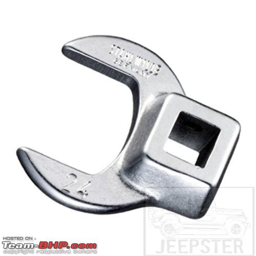

Wrench - Wikipedia, the free encyclopedia
Crowfoot wrench: a type of socket designed to fit some of the same drive handles as the regular socket but non-cylindrical in shape. The ends are the same as those found on the open-end, box-end, or the flare-nut wrenches. These sockets use for use where space restrictions preclude the use of a regular socket. Their principal use is with torque wrenches.
It is necessary to use a crowfoot spanner to access cylinder head bolts below the rocker arm.
If your technician does not have a crow foot spanner, please make one by cutting a ring spanner and welding it to a socket with a half inch square drive.
If he does not understand this, he will have to physically remove the rocker arm assembly, torque the cylinder head by using normal tools and then refit the rocker arm which is a cumbersome process so it is best avoided.
