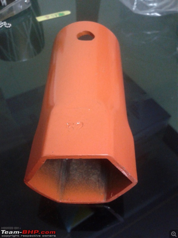

Sudarshan bhai, I have the SFRA in the rear. So I think i will be able to use this in the front only.
I didn't take a sample nut with me, but bought locknut from one of the Mahindra OEM dealers in Bangalore. And this fits the socket perfectly.

oye , you have already dealt with it properly
A remote possibility , the old & new large check nut sizes different ? Just a doubt as why the " H " I remember the 55 size then ?
I might be bit sleepy now but will check with a vernier tomorrow

Forgot to mention, be careful when tightening the nut, you have to hold it tightly against the nut, means properly pushing on to it while tightening . This nut is thin, & if care is not taken the " applicant " may slip the spanner & then effectively bang his head .
If lucky, then on the tire & if not,-- well ..
BTW also take care not to over-tightening it. Damage to threads is quite possible, again rendering it to the thin size of the nut & the thin wall size of the " Chillum " (spindle).
