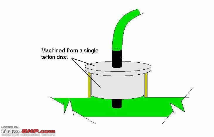

If I manage to seal the same radiator pressure cap, faultlessly, make a hole on the top and attach a metal nozzle and connect it to the degassing tank with a flexible pipe, will it work?[/i] It will also be the top most part on the radiator, right?
Thanks and Regards,
Is it really worth it Fazal saab? An engine designed to work well with a normal pressurized radiator will work without any of these mods on a modern bigger radiator with coolant surge system. Right?
Why butcher a good plastic radiator?

Dear Fazal therefore, you must actually seal the hole by using a plastic disc made out of same material, use a sealant which will withstand the rigors of radiator operation like temperature, pressure, oil contamination, dust ingress, salt etc, then develop a bleed and use it
Dear Sir,
Point understood, will do it with a machined teflon disc. Thank you again.
Dear Jaggu,
I will not butcher the plastics, but use the same pressure cap provision (explained by Sir Behram) the drawing below should explain.
The reason for this 'Jugad' is that I have a smaller radiator as a bigger one wouldn't fit. The extra degassing tank is for holding the extra circulating, liquid required for a 2500cc engine. The effort is not much and its worth it, to attain a lower engine temp.
BTW, Congrats on the ownership of 'Spidey' and also to Vijay for the 'Drawf', now whose Jeep is Shahnawaz going for?
Why not weld the teflon onto the plastic top of the radiator?

The plastic top tank of the radiator.......hmmmm. Still don't you feel the dummy I plan to make to replace the radiator cap will be a more solid than the thinner plastic body of the top tank?
Fazal, the difficult part IMO is tackling the pressure of the radiator, so any sealing should be pressure tested to certify the job.
