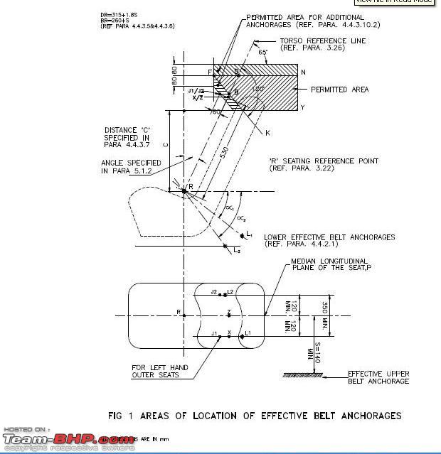

Tini, good suggestions but I need to say a few things -
1. Won't it be better if you use a hat section (I know C sections are easily available) but with a hat section you get a better seat area (for welding). I do not prefer bolting a 4mm (??) to a 18 GA SPCC.
2. The height of driver and co-driver will be different once you do this mod, how do you change the mounting for the other seat to equal the two 'H' points (for similar comfort) ? Will be tricky, doable though.
The mounting is different here too. If you must have seen, the other seat has a hat section spot welded to the floor. The hat section contains a cylindrical guide bush with a washer at the end and equally supported at the floor sill panels through webbed reinforcements. A perfect job will necessitate overview of all these criterion's.
3. There are safety repercussions too, the seat belt angles will also change. What I am trying to say is, even though seat belt and seat are present they will not be working in the manner they are supposed to.
Hope you got my point, I am attaching a pic for illustration.
I have gone though hell to get all this done, that is a different story though. I understand a normal guy need not think of all this before doing such a simple mod.
Phew !
Spike
Pic courtesy- (AIS 015 Seat belt Anchorage) from ARAI website
